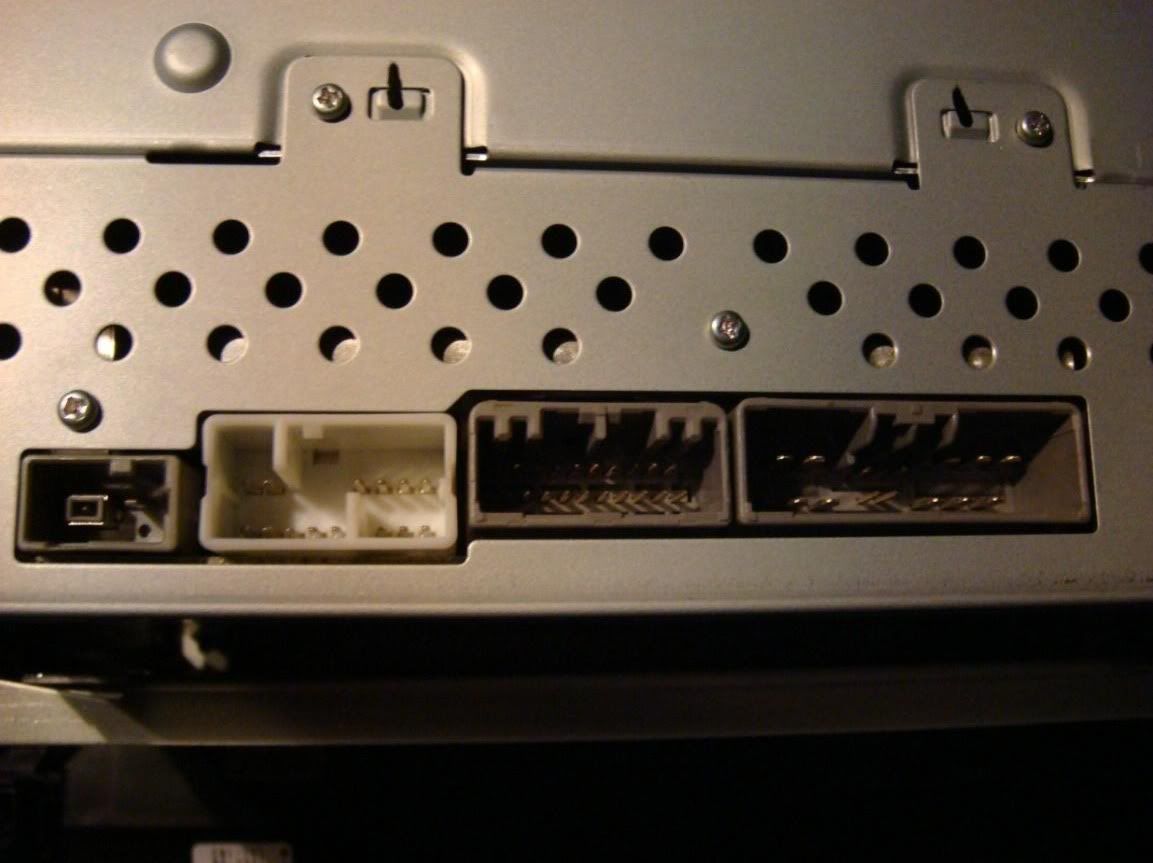

hey guys, Im looking to get an ipod/aux/bluetooth adapter for my 06 FD1.
I need to know something though, by any chance does our OEM head unit have a CD changer harness plug at the back of it?
I believe that the FD2 have CD stacker with their OEM head unit.
no lol, the cd stacker you speak of is inbuilt
yeah I know that but I saw a DIY that had a harness plug at the back of it. here's the pics (note: its the white plug).
The Adapter I'm planning to get requires this plug at the back of my OEM Head unit.
So yeah Im just wondering if out FD1 has it.
http://i11.photobucket.com/albums/a1...dobeReader.jpg
http://i11.photobucket.com/albums/a1...obeReader1.jpg
not sure about the vti cos they have a single stacker, could always check? not that hard to take apart the dash

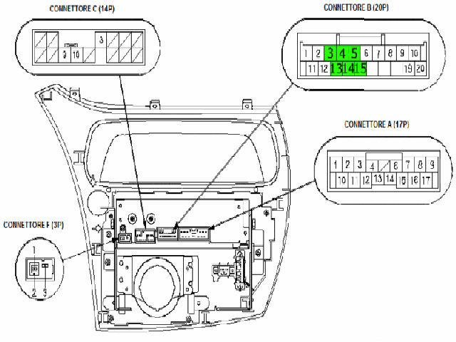

this one might help you
B3 = AUX SGND (ground for the signal)
B4 = AUX SH GND (shielding ground for preventing the signal interference from other devices)
B5 = AUX GND (AUX detection wire for switched type female jack)
B13= AUX L (Left signal)
B14 =AUX R (Right signal)
B15 = AUX DET (AUX detection wire for switched type female jack)
http://i2.photobucket.com/albums/y14...0in/FDHU-1.gif

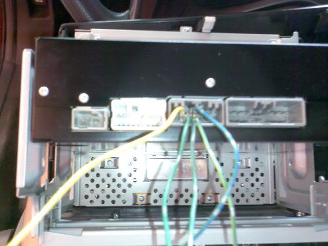

ghetto harness
Connect a jumper to pins B5 and B15. Connect wires to B3, B13 and B14, these wires leads to the auxillary jack.
http://i2.photobucket.com/albums/y14...n/Image007.jpg

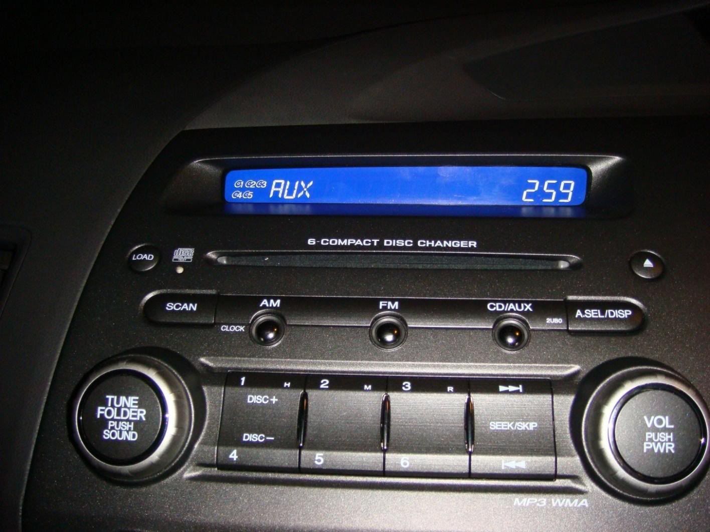

if you want an oem look..you can order this to your dealer
http://img.photobucket.com/albums/v1...Forum/AUX1.jpg
