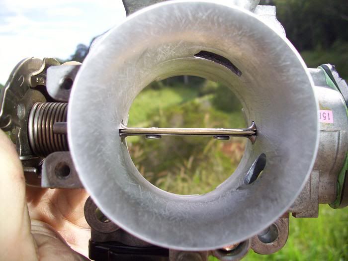

U can file down the throttle rotor,this will increase the range.

But 1st,I would take the TB off and make sure the throttle plate is opening 100% (and closing completely too,but this should be fine if the idle is fine).Hopefully it's not opening 100% and U can file down the rotor and get that range need back.
Like this:
http://i774.photobucket.com/albums/y...100_2906-1.jpg
When your CT is set the range is 0.64V short.
When your WOT is set the range is 0.37V short.
