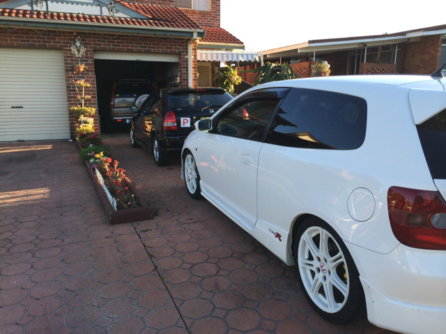

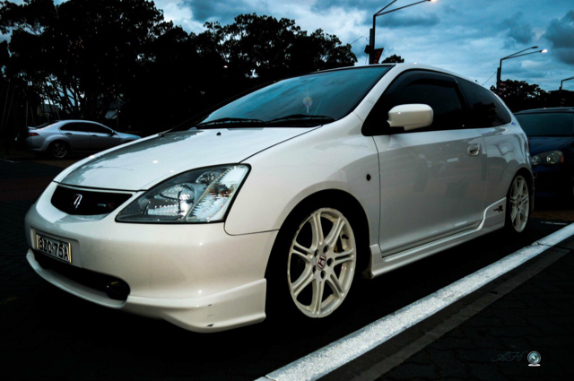

Attachment 27880
Attachment 27881Attachment 27882
Looks really good at that height, it's duuuuuuuummmmmped. have you decided on wheels? how long has it been at that height?
hehehe I've just had to learn to avoid some Caltex driveways.
Potatoes.
