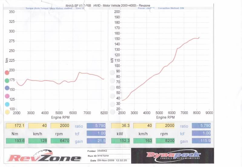

Hmm.. I got 152.3kw on a hubcentric dyno with just GruppeM and a tune (if you can call it that) on a VAFC2.

Symphorced --- I have tuned a couple of ep3 on the dyno and your reading is very good. Congrats on a good tune.

Would recommend the new Cusco Engine oil Fully synthetic 5w-40. Will post up the Apexi AFC Neo tune as well using the same oil tomorrow. Have to get to work tomorrow and print out from the Dynapack CPU.
