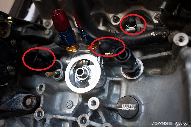

and the 2 port that has been blocked off in the pics what else can be done to them ???
have a look at the Energy Dynamics (EnDyn) Breather Kit
comes with everything you need to fit it.
http://www.theoldone.com/components/...eather-Kit.jpg
or alternatively, you can source the parts individually.
I am running this kit but my mate and I managed to make the same thing for cheaper using bits and pieces. Either way works great and reduces oil usage.
What do you mean? If mean the black fittings with no hoses in them they go to a breather tank like the one above - take note that the breather on that is a defect as it's venting to atmosphere, if you want it to be "legal" it has to be plumbed back. (it's in that kit but that endyn kit is pretty expensive and his really slow to ship)
these ones
They are deleted coolant lines, I don't run a heater or oem oil heat exchanger. Nothing to do with breather.
The red circle on the left is one of the breather ports.
My setup uses prelude fittings out of the back of the block, and push on hose like what you get with the endyn kit
