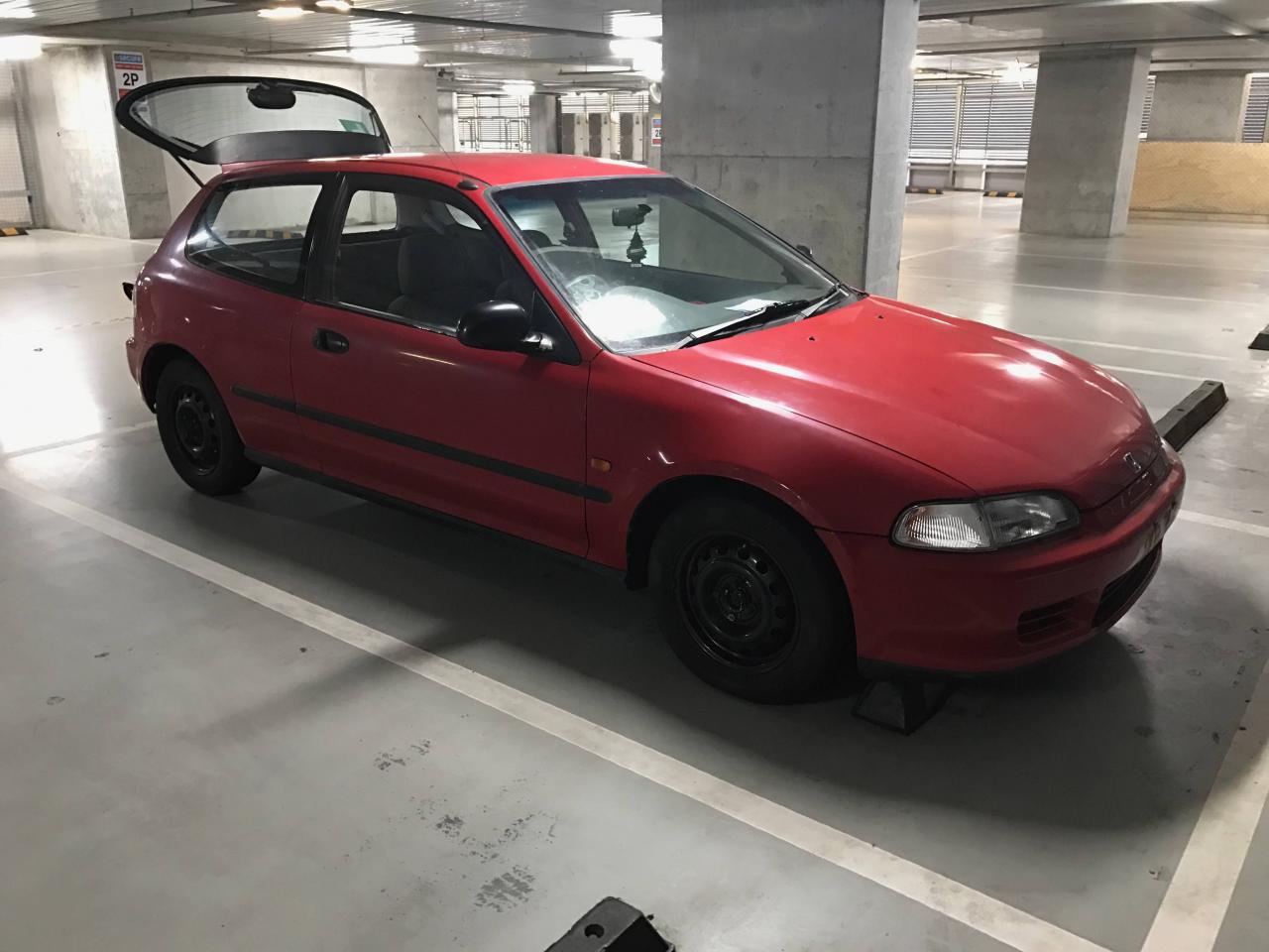

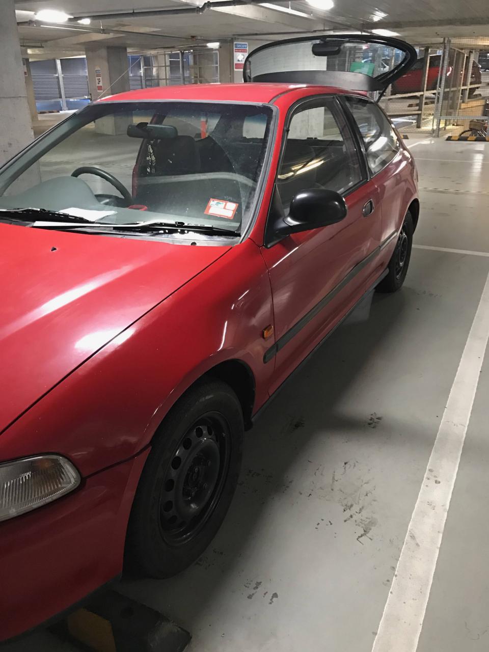

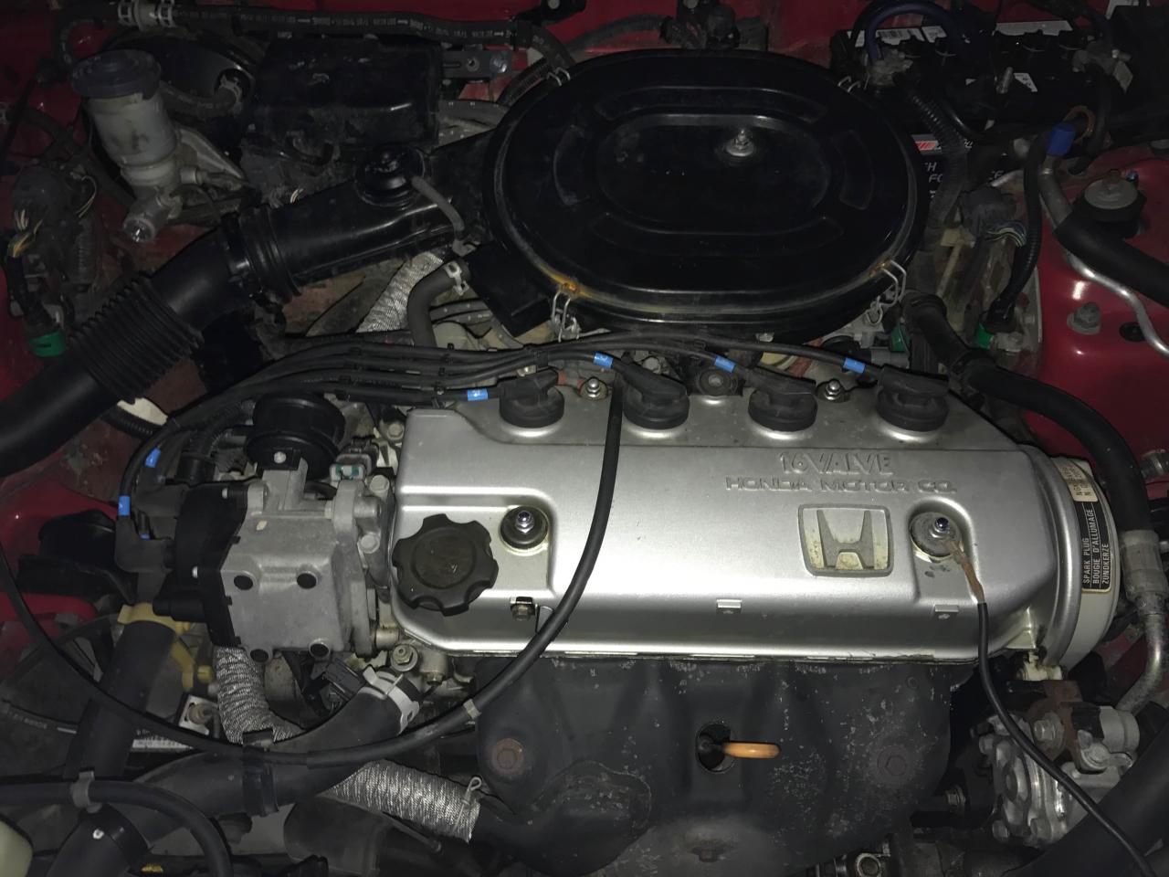

The Car: Well after much deliberation about which car would be best suited for such an application, and studying the WTAC open class rules, the decision of a hatchback was made and with a 1994 Honda Civic showing up for a tiny $400 with no signs of rust and slightly leaky engine, the purchase of a small yet incredibly slow and smelly car was made.
Attachment 30187
Attachment 30188
Attachment 30189
Attachment 30190

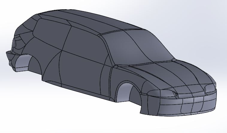

Step one was to start to develop a complete CAD model of the car. I spent days searching the Internet looking for a CAD model but none existed, so it was time to make a measuring jig and mark over 300 points on the car to create an accurate CAD model that aerodynamics could start to be modelled upon. If anybody is interested in this CAD model, more than happy to share it around as it took so long to make.
Attachment 30191

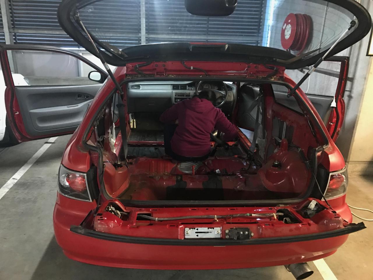

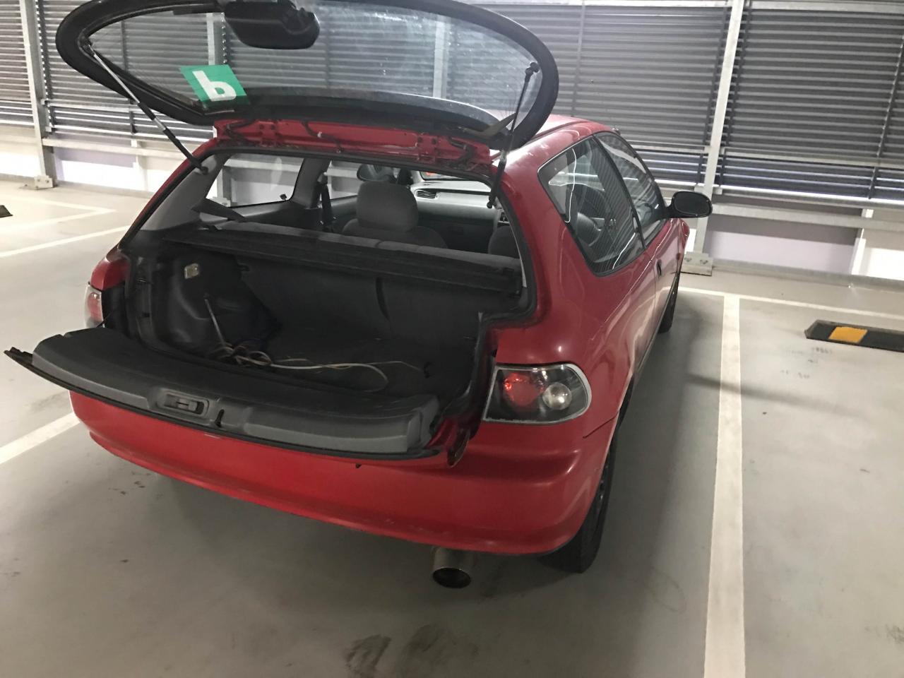

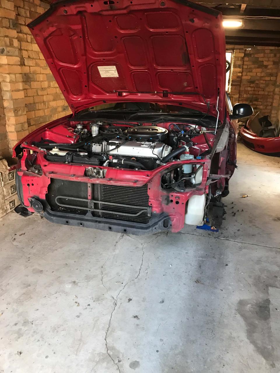

Stripping the car and discovering its past. This was fun as I intend to use nothing from the interior other than the dashboard, door cards and steering column so everything was out in a hurry. Still have quite a few parts hovering around the joint so if anyone is looking for that missing part, I might have it. Anyway, the car was stripped and then put up onto jackstands, ready for the exterior to also be stripped and most parts will be custom throughout this build.
Attachment 30192
Attachment 30193
The main pieces to keep were the front fenders, the lower hatch and the bonnet. All of these will be modified and recreated using Carbon fibre to limit the weight and also allow the body to 150mm wider to allow for wider tyres and additional shaping for aero. I intend to do a full how to guide on the creation of composite panels so anyone can do it at home.
This is currently where I am at with the build. The front left fender has been shaped and is going through the final stages of sanding. Once I can get access to my computer, I will be looking to upload photos on the progress to date and also elaborate on anything interesting.
