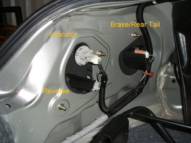

Here’s the exposed light wiring after removing the boot panels:
http://lh5.ggpht.com/_J2cP5UE8sL0/Sp...N7c/s800/3.JPG
Unplug the wires and using an 8mm socket, remove the four (4) nuts holding the light to the car. He’s a view after from the outside:

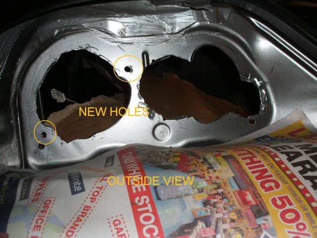

Here are some pictures after cutting:
Outside view:
http://lh6.ggpht.com/_J2cP5UE8sL0/Sp...ss/s800/12.JPG
Inside view:
http://lh6.ggpht.com/_J2cP5UE8sL0/Sp...QU/s800/13.JPG
The four (4) bolts that fix the AP2 lights are different from the AP1. You need to drill two (2) new holes into the body panel. Mark these holes using the light itself. Press the light into the body work and the tips of the bolt will scratch and mark the paint. Then drill two (2) holes. Test fit the light to make sure everything fits well.
http://lh4.ggpht.com/_J2cP5UE8sL0/Sp...00/s800/11.JPG
Now use a Dremel die to clean up the rough edges and sand it back before giving it a quick spray of paint to prevent rust. I just did a quick coat using Silver Australian Export paint from Supercheap Auto for $2.
http://lh6.ggpht.com/_J2cP5UE8sL0/Sp...o/s800/14a.JPG

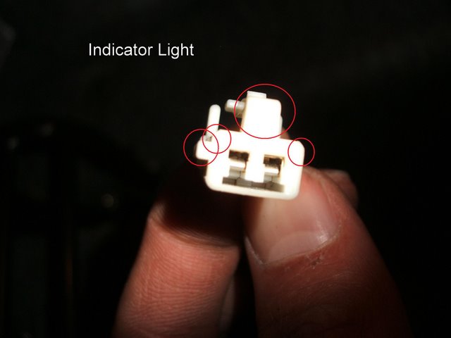

Indicator Light
My AP2 lights came with the light globes and sockets, so plugging in the connector simply required trimming the male plug as well.

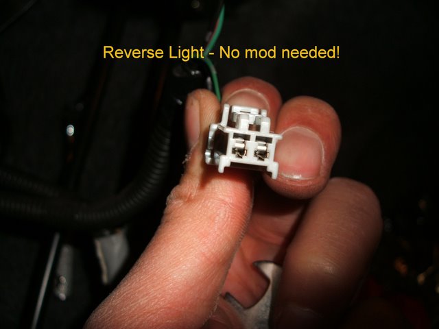

Reverse Light
Simple plug and play. No modification required.

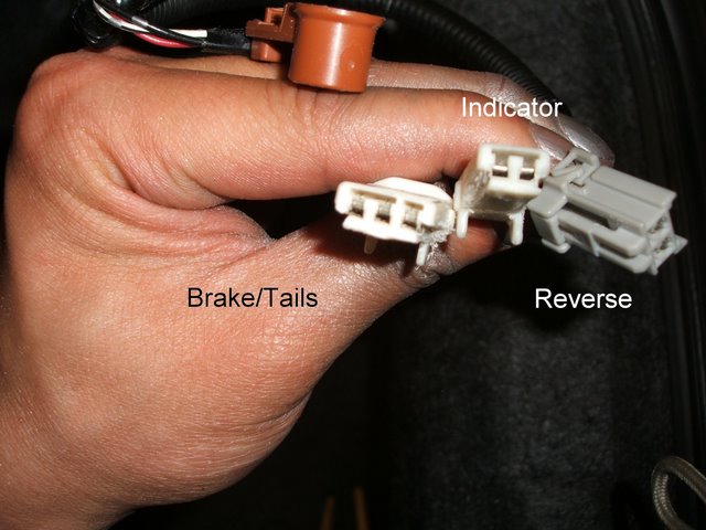

Picture of all three plugs after trimming:
http://lh5.ggpht.com/_J2cP5UE8sL0/Sp...yk/s800/23.JPG
Test fit your plugs and turn on your lights to see everything is working!
