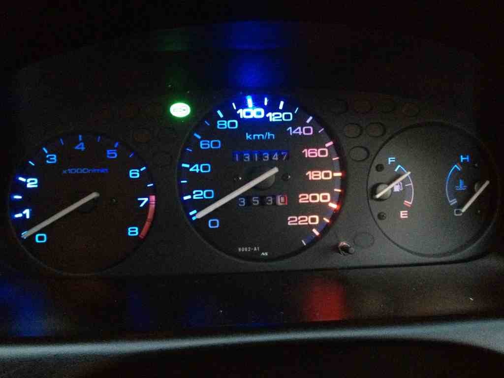

Now if you have followed all the steps properly you will end up with something like this. Dont mind the factory headunit it will be replaced by somthing a bit nicer shortly and ill be working on the amber clock to get it white too.
Before:Sorry for the dodgy pic my phone camera doesnt like taking pics in the dark, looked more amber than this in person.
http://i1220.photobucket.com/albums/...s/IMAG0518.jpg
After:
http://i1220.photobucket.com/albums/...IMAG0802-1.jpg
http://i1220.photobucket.com/albums/...IMAG0581-1.jpg
http://i1220.photobucket.com/albums/...s/IMAG0806.jpg
Ive got it set up so everything its white except the hazard and demistors are red leds and the AC and vent buttons are blue, but you can have any colour once you remove the amber backing from the gauges if your unfortunate enough to have it.
If there are any questions or if i have missed anything let me know and ill sort it out.
