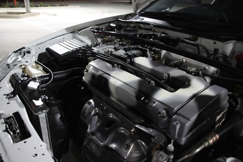

Once done you can now see my result :
PS.. There was 2 wires i extended which was the grounding wire ONLY, others were alarm and fog light based :D
http://xposed.au.com/wiretuck/3.jpg
From Engine Bay to fender.
I basically cabled tied the loom to the boot puller thingo which i habnt had any rattling problems.
http://xposed.au.com/wiretuck/4.jpg

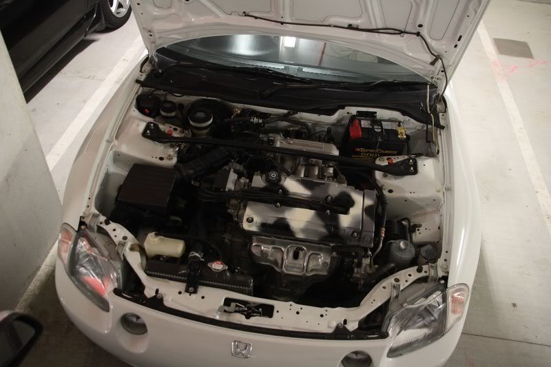

Now put it all back up! and it may look like this!
http://xposed.au.com/wiretuck/8.jpg
http://xposed.au.com/wiretuck/9.jpg
SORRY ABOUT THE QUALITY OF THE PICS!
PS.. currentlyt working on the middle part of the bay.. will post that up as well
