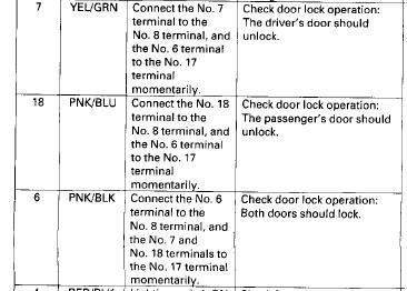

Just installed a viper 791xv into my 2000 s2000 but can get the doors to lock/unlock. everything else is great besides the door
was wondering if anyone knows hows to do it. read some stuff on the net and i might neeed some relays or conecting stright into the keyless entry module????? plz explain
would be great if u have instructions or pics to assit on how its done
