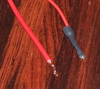

1. we need to run 2 extra wire from steering wheel to audio unit. means we need 4 pins and about 1.5 m cables.
2. take off 4 pins from stock cruise control button, but if u car is manual, i reckon u have to get these from computer pins.
http://i171.photobucket.com/albums/u...da/diy/2-1.jpg
http://i171.photobucket.com/albums/u...da/diy/2-2.jpg
3. assemble 2 pins at one side and 2 pins at other side with cable running between them about 1 - 1.5 m length.
4. don't forget to put some codes/label on them
