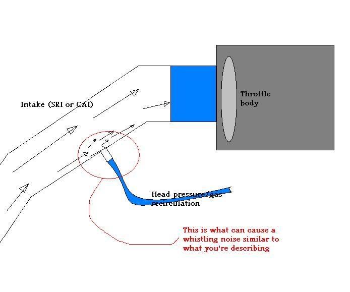

here is a quick diagram of what causes mine to whistle
note my arrows are air flow.

I run a Spoon filter on my box, with the lid off and due to the plastic foam material it doesn't muffle the sound like the OEM paper style filter and I get a similar sound with part and full throttle. I've heard this is a trait of some of our plenums/throttle bodies.
If it's only changed sound recently I'd be checking for breaks or tears in the your filter or intake pipe.
Mugen ones whistle, thats just the design.
