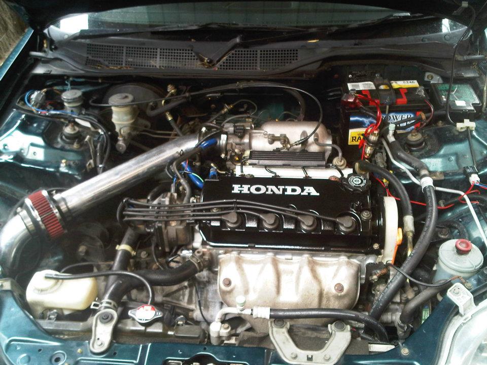

Step 5: remove your intake pipe, spark plug leads from the valve cover and distributor, and place them to a side. Do not remove the leads from the distributor!
Attachment 20275
Step 6: Unbolt your valve cover screws and take the valve cover off. Some may be hard to come off, so just knock it a few times. (it is very important that nothing gets dropped into the cylinder head before or after the swap!) Remove the necessary covers just beside the cam gear needed for removing the head.

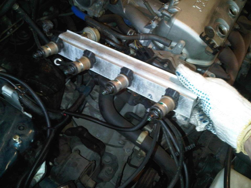

Step 8: Unbolt the screws that are attached to your fuel rail. They are the ones that are mounting your fuel rail on the the intake manifold. Be sure to gently remove the fuel rail as the fuel injectors that are attached to it are fragile.
Attachment 20260
Attachment 20285
