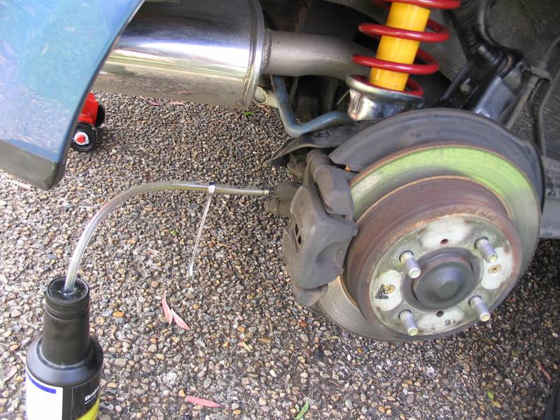

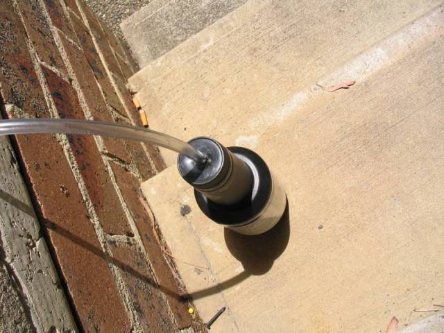

1. Grab your piece of clear piping, make a hole in the top of the container use wish to use to collect the old fluid into and feed the pipe through like so:
http://www.ozhonda.com/gallery/data/.../3IMG_4733.jpg

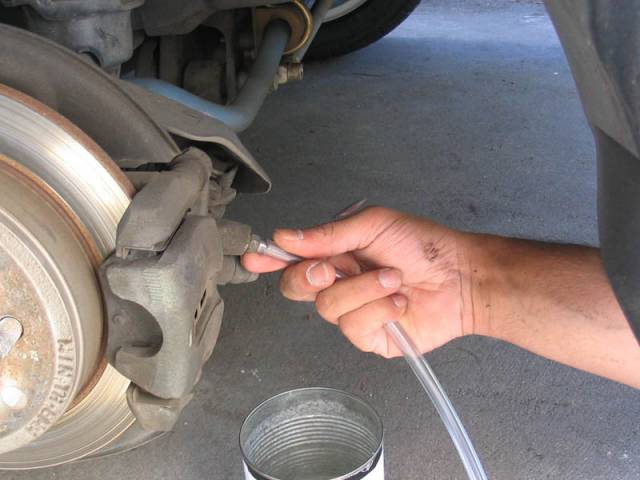

4. Remove the dust cover off the bleed nipple and connect the clear piping/hose to the bleed nipple as so:
http://www.ozhonda.com/gallery/data/.../3IMG_4734.jpg

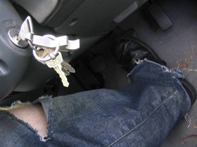

5. Ask your mate to jump into the driver seat and tell him to press the brake pedal (DOWN) and then release it (UP).
http://www.ozhonda.com/gallery/data/.../3IMG_4735.jpg
6. After he/she has pressed and release the brake pedal, undo the bolt head of the bleed nipple and some of the old fluid should start going through the pipe and into the old container. Repeat this UP/DOWN procedure around 3-4 times or until the new fluid starts coming through the nipple.

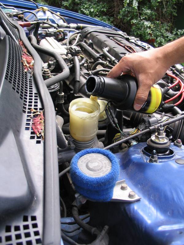

7. As you are doing this, keep topping up the fluid in the master cylinder reservoir. You MUST make sure that the level in the reservoir does not drop below the low mark or else air will enter the system. This is a big NO NO!
http://www.ozhonda.com/gallery/data/.../3IMG_4739.jpg
