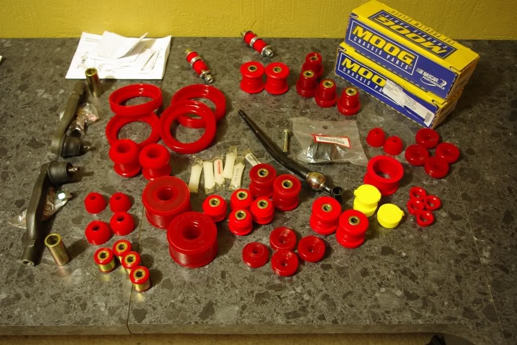

Heres the Energy Suspension Masterkit Plus everything else missing from it. And there is alot missing from those kits so dont think 250 Bucks and your set. This all cost me $430 including shipping from the US. And i installed them myself

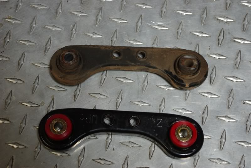

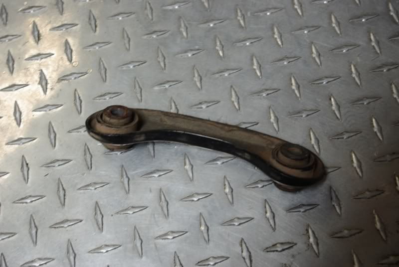

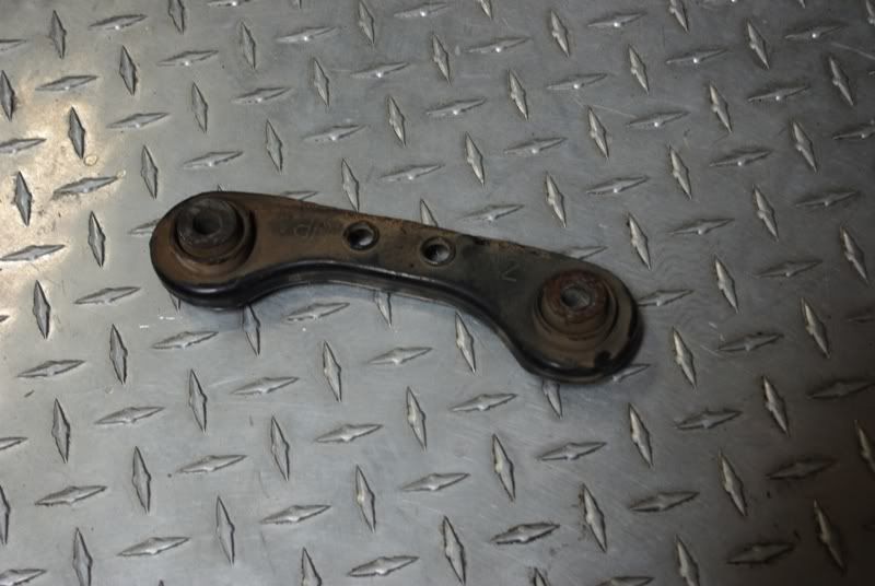

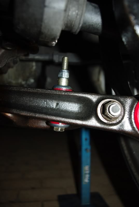

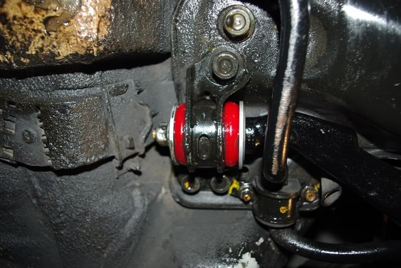

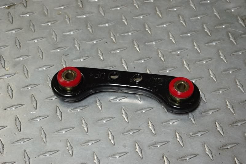

Heres the work:
http://i101.photobucket.com/albums/m...c/IMGP9831.jpghttp://i101.photobucket.com/albums/m...c/IMGP9832.jpghttp://i101.photobucket.com/albums/m...c/IMGP9833.jpghttp://i101.photobucket.com/albums/m...c/IMGP9834.jpghttp://i101.photobucket.com/albums/m...c/IMGP9836.jpghttp://i101.photobucket.com/albums/m...c/IMGP9837.jpghttp://i101.photobucket.com/albums/m...c/IMGP9838.jpghttp://i101.photobucket.com/albums/m...c/IMGP9839.jpghttp://i101.photobucket.com/albums/m...c/IMGP9840.jpghttp://i101.photobucket.com/albums/m...c/IMGP9841.jpg

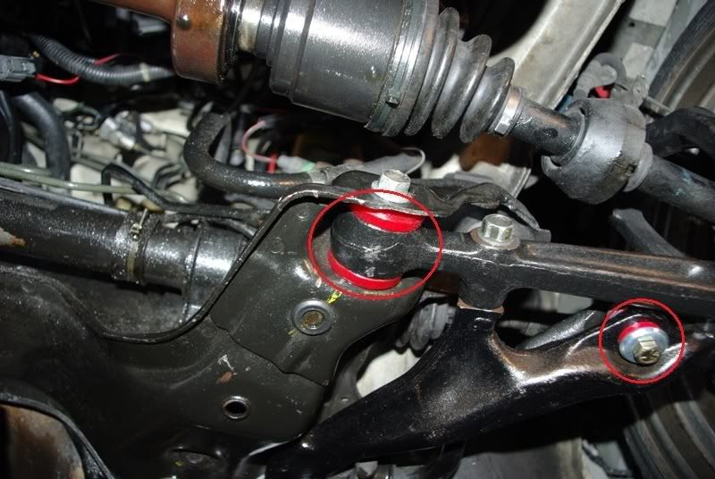

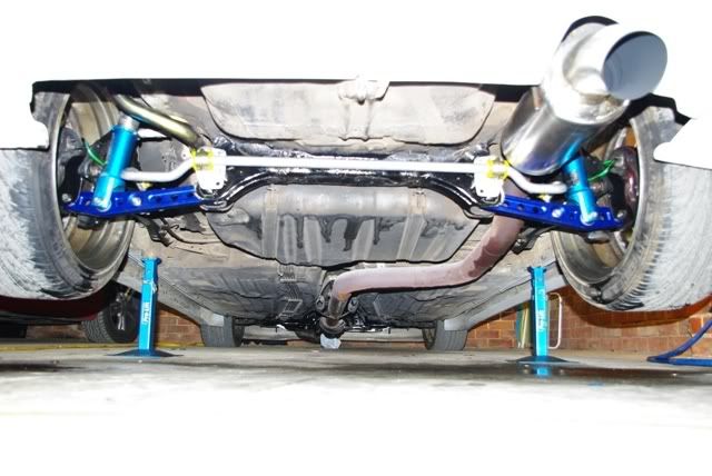

I didnt need to do much bushings on the rear, just the compensator arms and the Trailing arm bushings as i had them all replaced when i installed this.
http://i101.photobucket.com/albums/m...c/IMGP8450.jpg

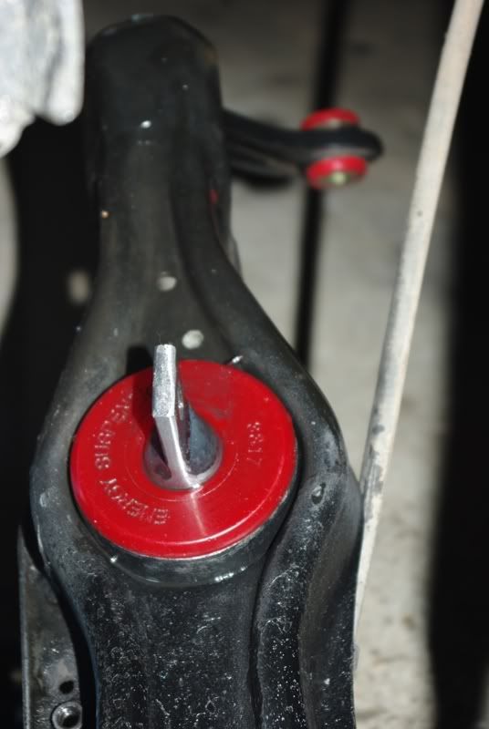

This is it here man... the front complete LCA's with ES are around 100 including delivery all up.
All u need is 17mm, 19mm, and 14mm spanner and/or sockets. hole saw bits for your drill, vice, hammer, jigsaw or electric saw and some spare time.
I see,so there's 4 for the complete front LCA's aye...Hmmmm.I wonder if it's worth doing the other 3.The Front LCA bushes I have (in my thread) I think are the top left ones (could be the far right one though),do U know Fast fwd?
I'm thinking if I replace only the one I have,is it enough or should I do other's also?

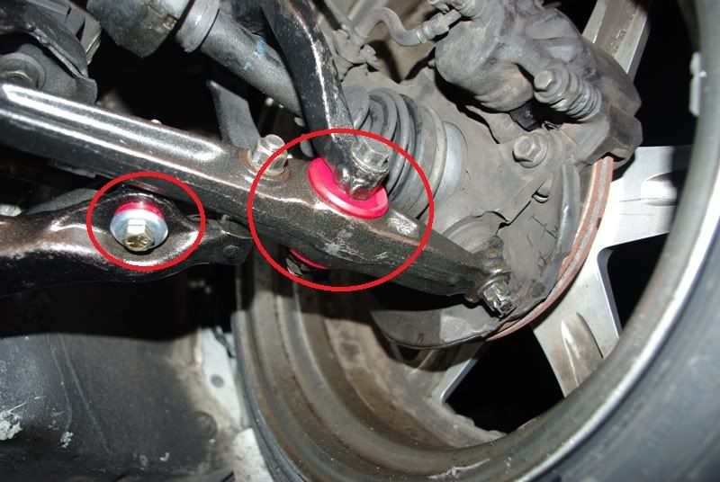

The front LCA's have three bushings the 4th circle in the middle is just the sway bar linkages.
The far left and the far right bushings are the most important on the front LCA's as they get the most use and get the most wear and tear. The far rear one's in that picture werent rearly that worn even after 270 thousand plus k's.
I suggest if your not that picky and just wanna do some and save some cash just do those two out of the front LCA's
And the Rear Trailing, Rear LCA's and Rear Compensator arms are all the most important. The rest wont need that much attention until 300+ thou.

The front two LCA bushings which need to be replaced mainly are these in the yellow circles.
http://imgur.com/k2xDw.jpg

So i went through Energy suspension US. I bought all the bushings including delivery as i said before for $430. Thats every single bushing on my EG becides engine mounts. Delivery was around $60 AUS and came within 5-7 days. I suggest just go with the US dealer. They have every single thing you need.
