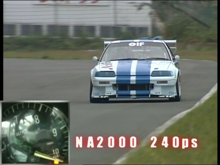

there is a white and blue gen2 NA crx thats running 240ps, its only 720kgs i think and is velli velli quick!
its on bmi - battle at 10krpm and kills s2k's, type r's and nsx's :D
CRX y0!
http://img.photobucket.com/albums/v4.../10krpmcrx.jpg
B16B 1600cc @ 280hp... Nup...
can i have a 10krpm tacho too panda??
lol sure, oh and i just remembered the crx had a b20 in it....(hence the NA2000)
still havent seen that dvd :(
my mate took screen shots on his pc for me lol
and i cut and paste the tacho from one shot to that one
