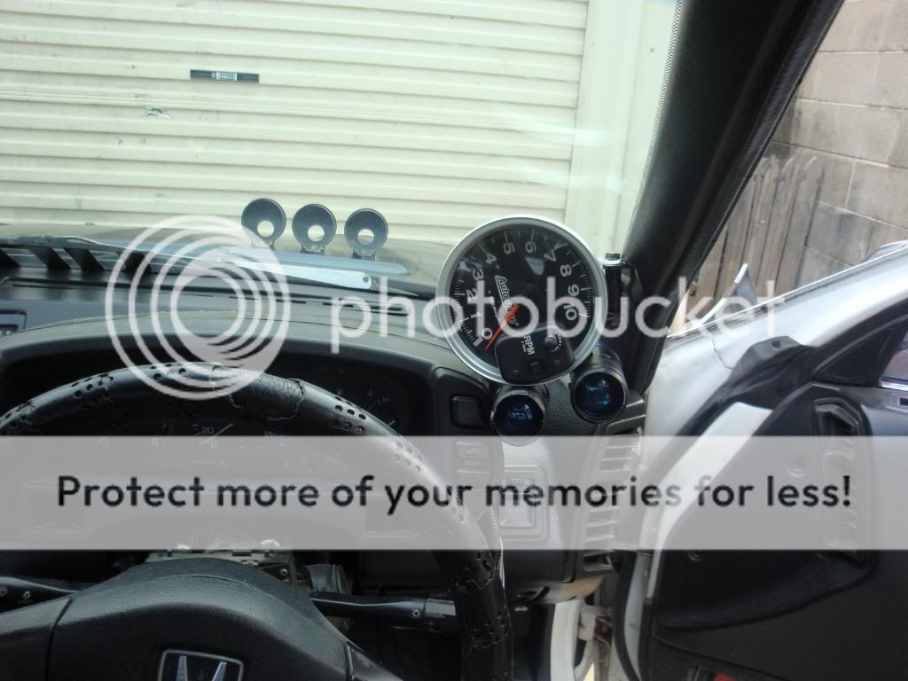

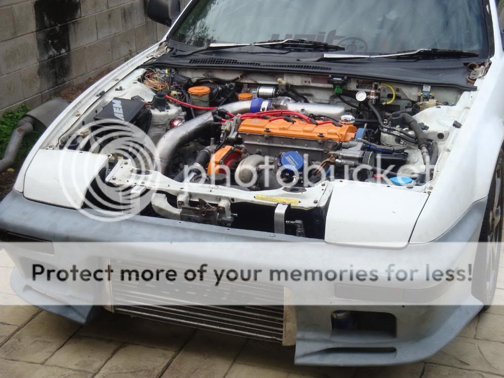

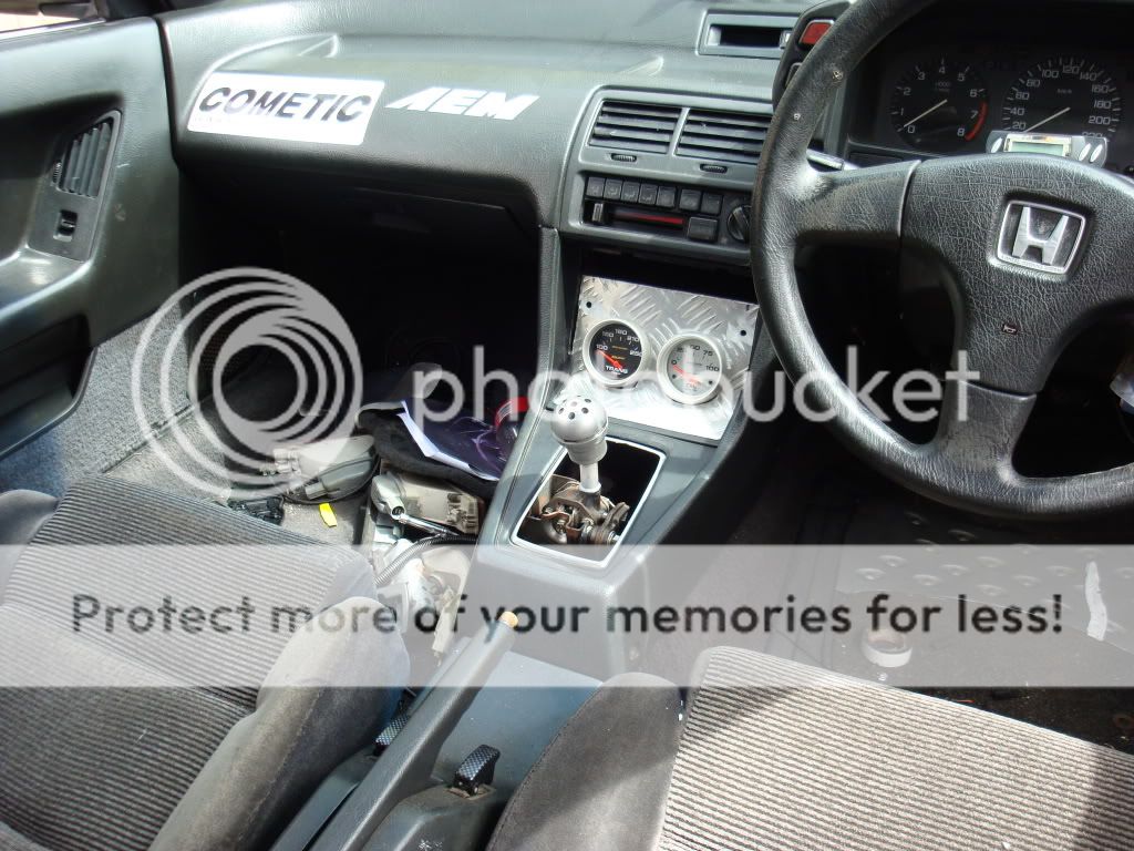

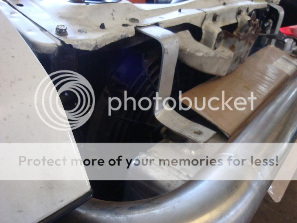

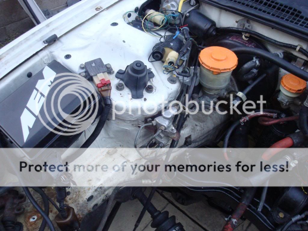

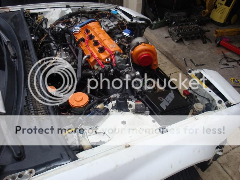

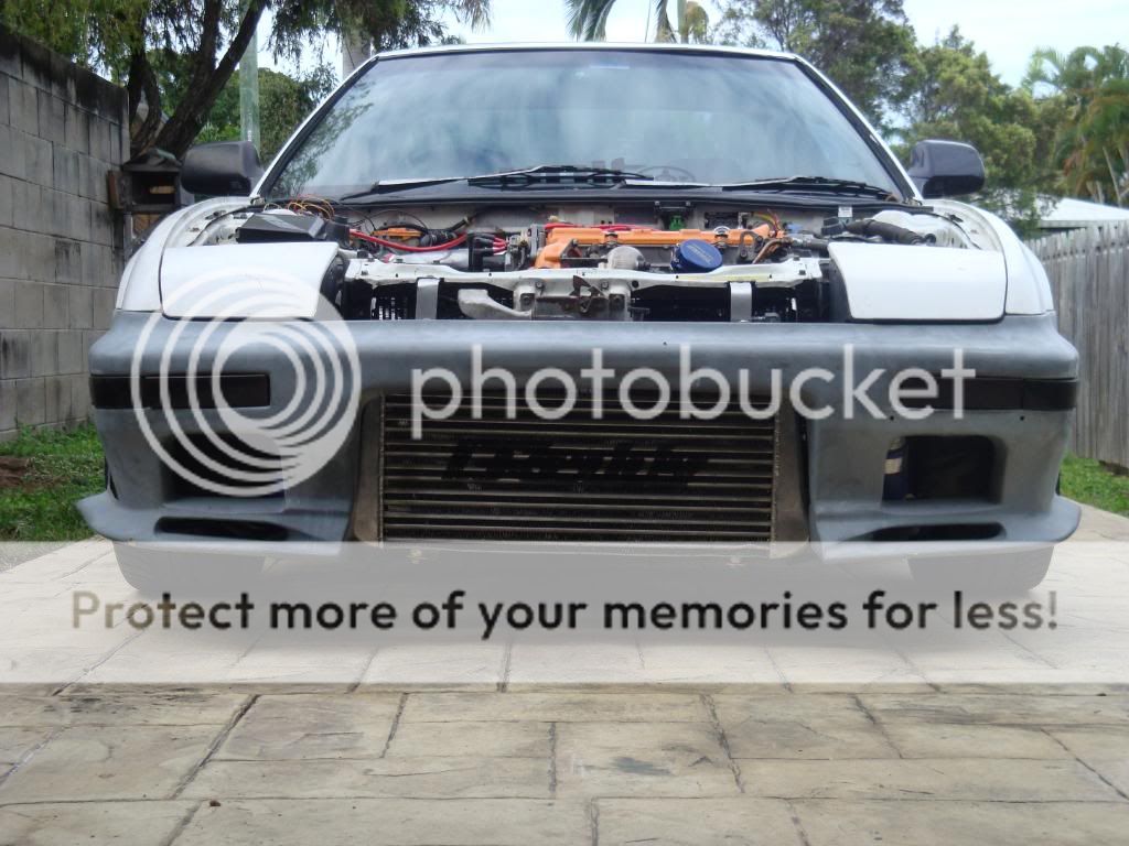

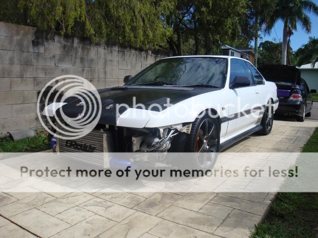

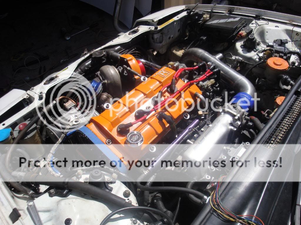

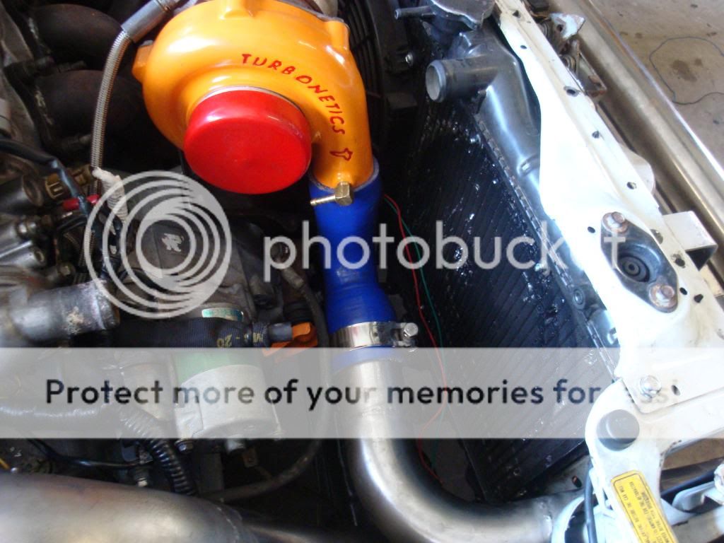

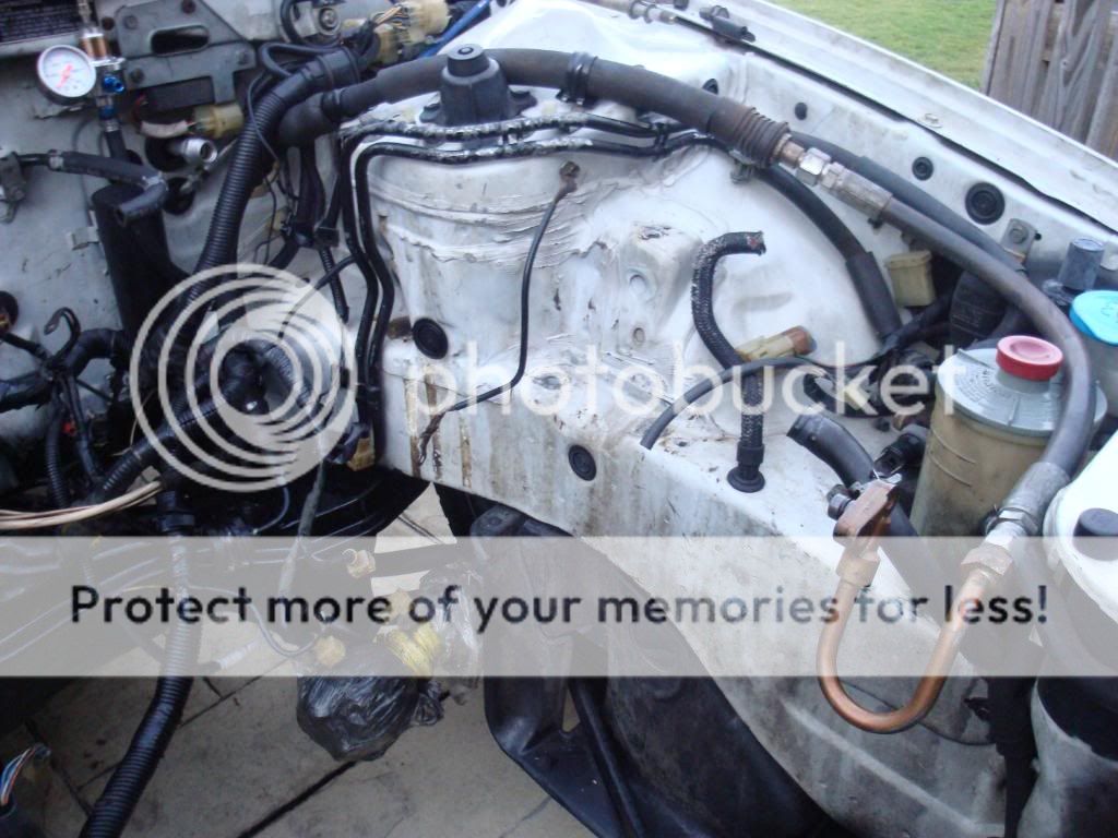

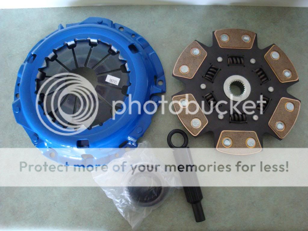

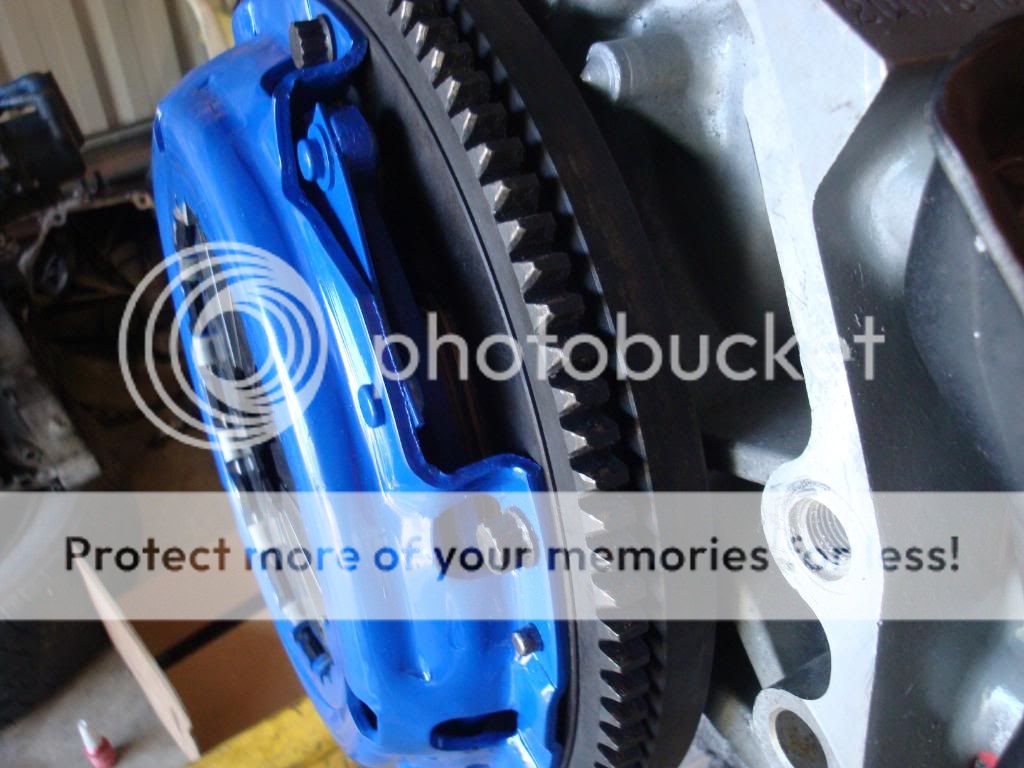

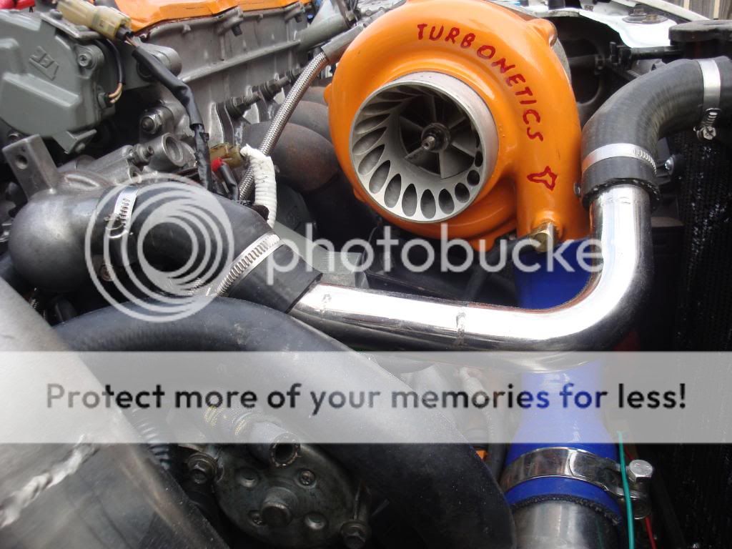

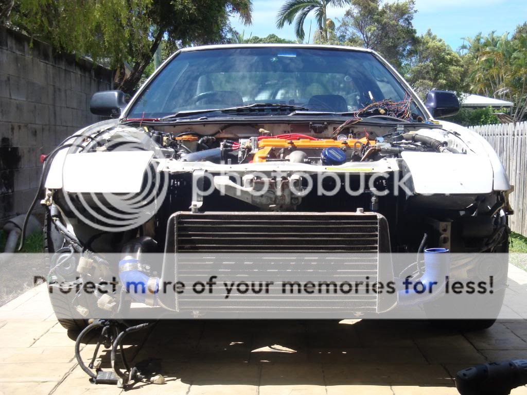

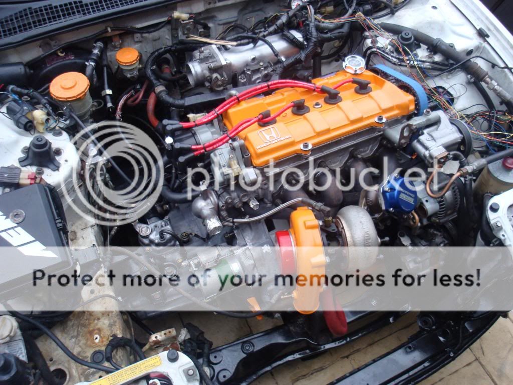

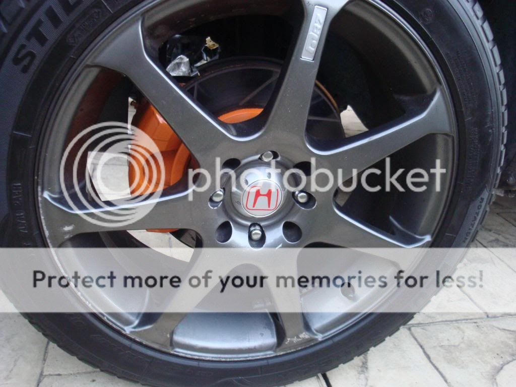

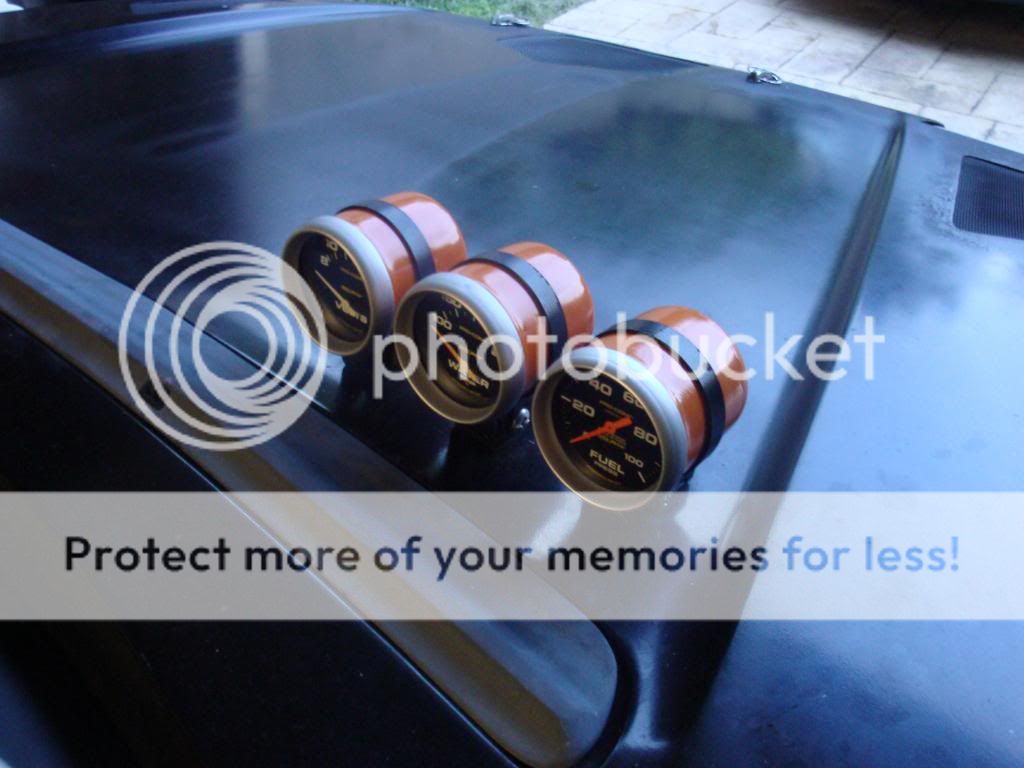

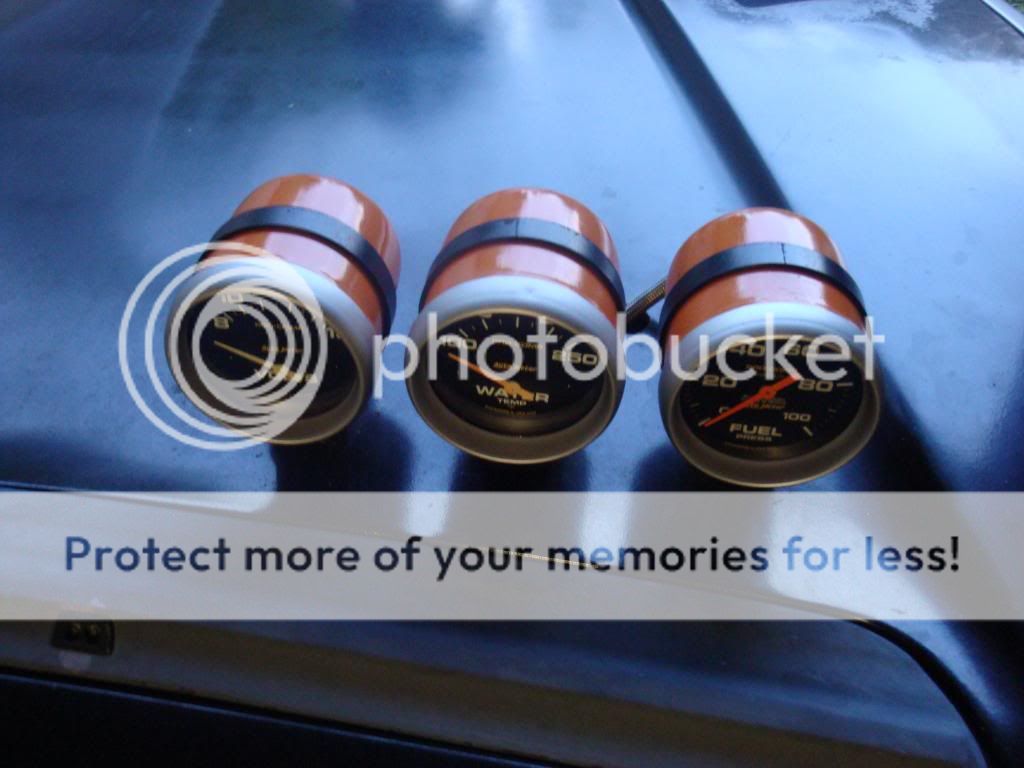

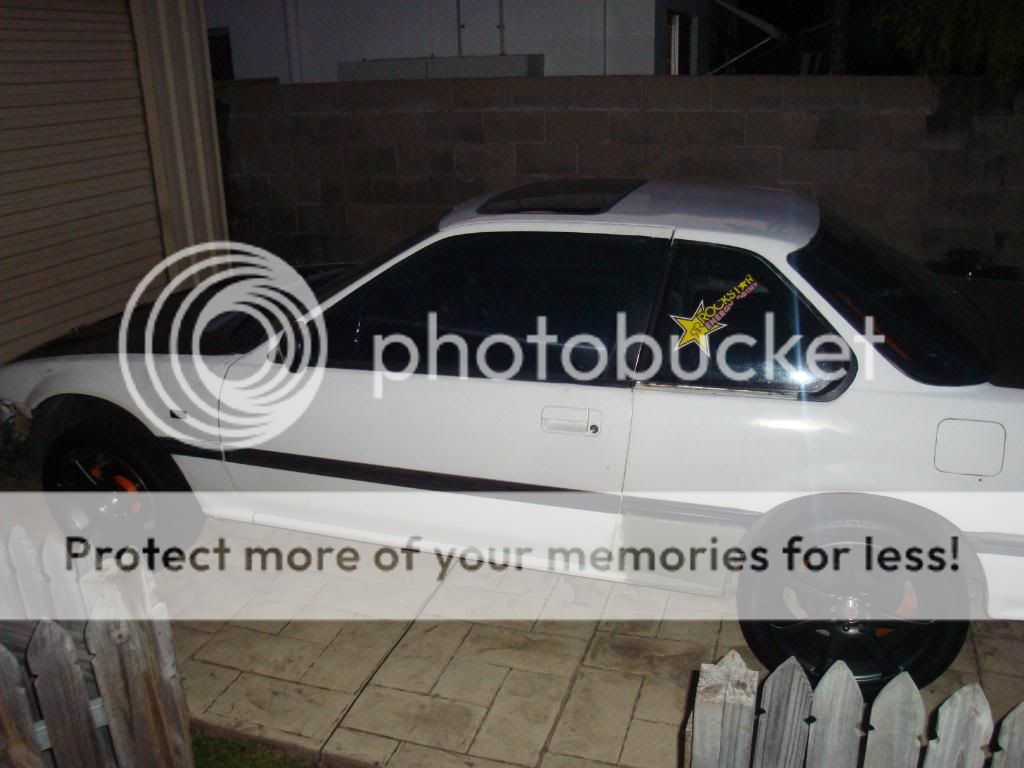

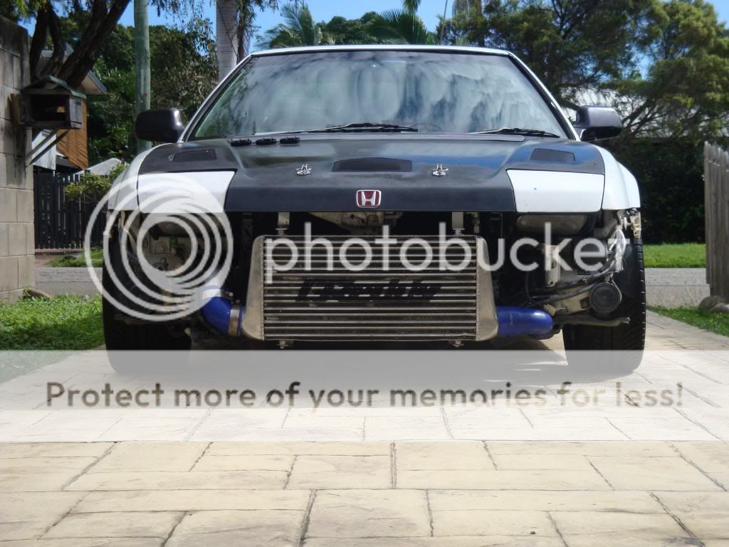

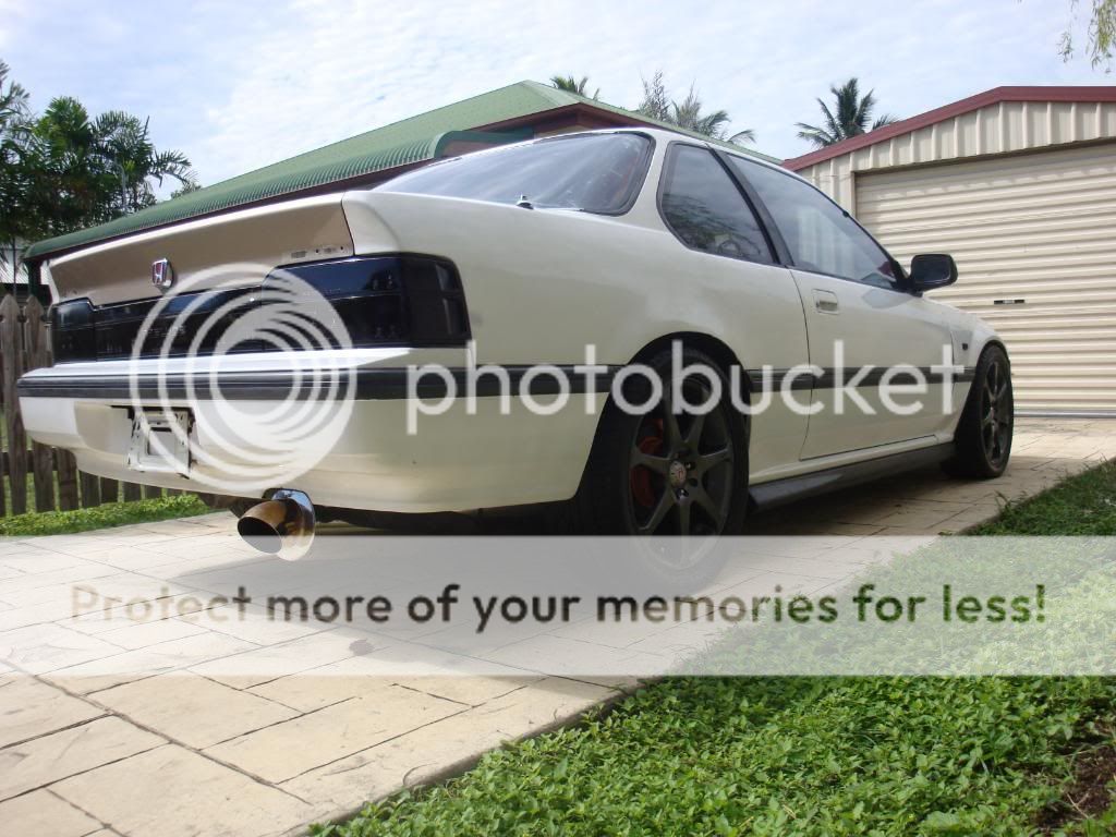

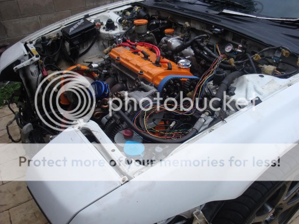

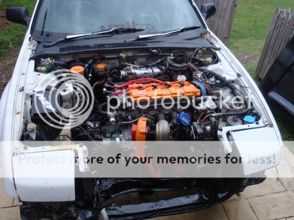

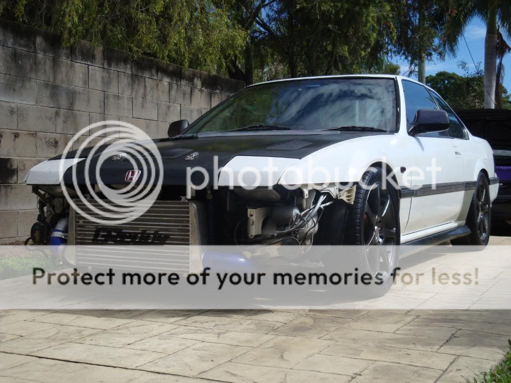

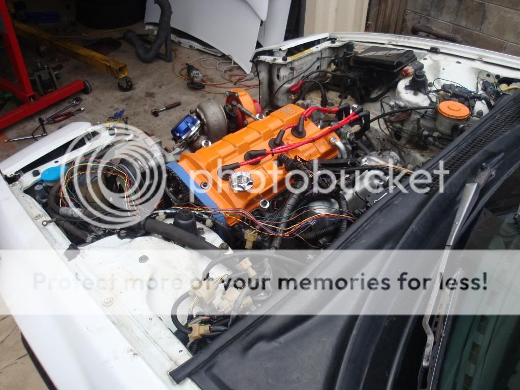

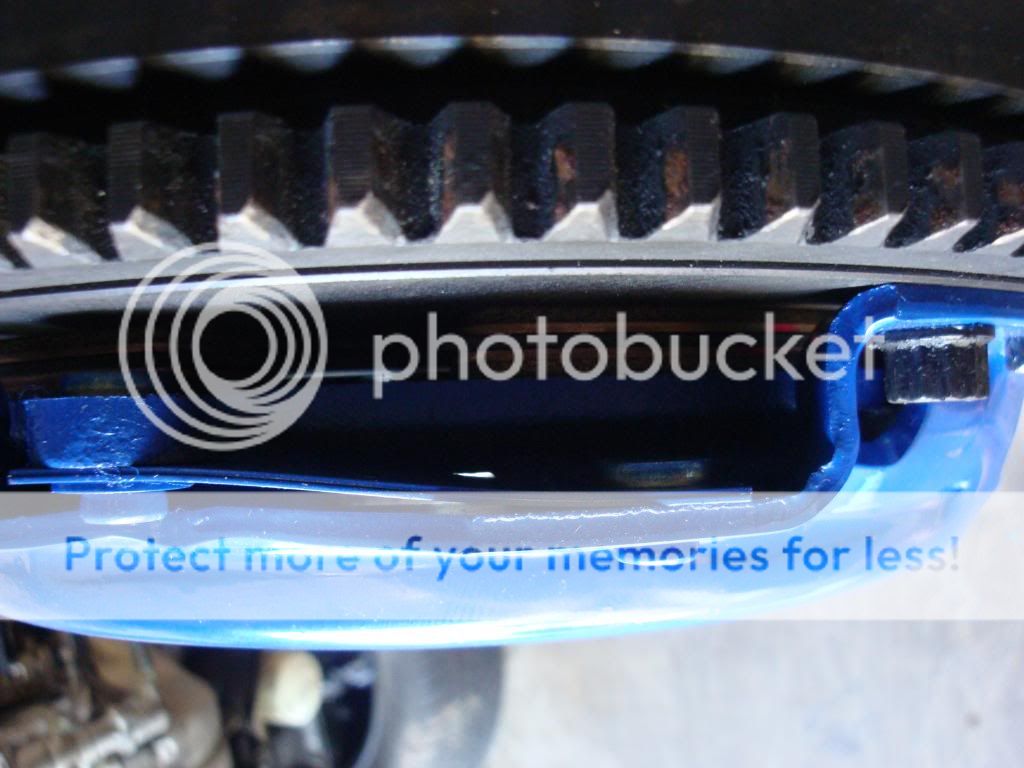

thought id share with everyone my toy . running a honed/decked block , stock crank , acl race series bearings , scatt h22a h-beam forged rods , custom off set dished JE pistons , pro seal rings , arp stud kit , cometic 0.050" 5 layer MLS head gasket , c/r 8.0:1 , port/polished head , heavier valve springs , aem cam gears , gates racing timing belt , modifed manifold ( opened up inside ) rc 650cc injectors , sard FPR , custom over sized fuel rail , custom turbo manifold , turbonetics GTK450 turbo , turbosmart 38mm wastegate , single 3" stainless exhaust to 45'/ cannon dump pipe , large FMIC , 3ltr surge tank , walbro 255lph lift pump , adaptronics e420c ecu , turbosmart type3 supersonic bov , turbosmart eboost 2 ebc , custom half roll cage , accord side skirts , modifed front bar , etc etc . things to come new 1991 s2 3g prelude with 5 speed , ncp 500+ hp clutch kit , k-sport kontrol pro coilovers , whiteline front sway bar/strut brace , 94 vtir calipars+slotted rotors , goodridge braided brake lines , bosch 044 main pump , and just a few other small things .
