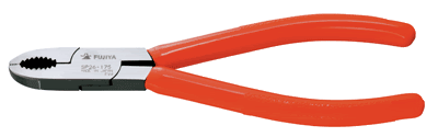

I have this plier
fujiya sp26-175 screw plier
very good tool.

get my thing from jaycar, you won't regret it.
use the fujiya item for screws and use irwin bolt grips for hex bolts.
I had a rounded lug nut, put on the 17mm bolt grip and out it comes without a scratch on the bolt grip.
the more you turn, the more it grips.
not cheap though.
