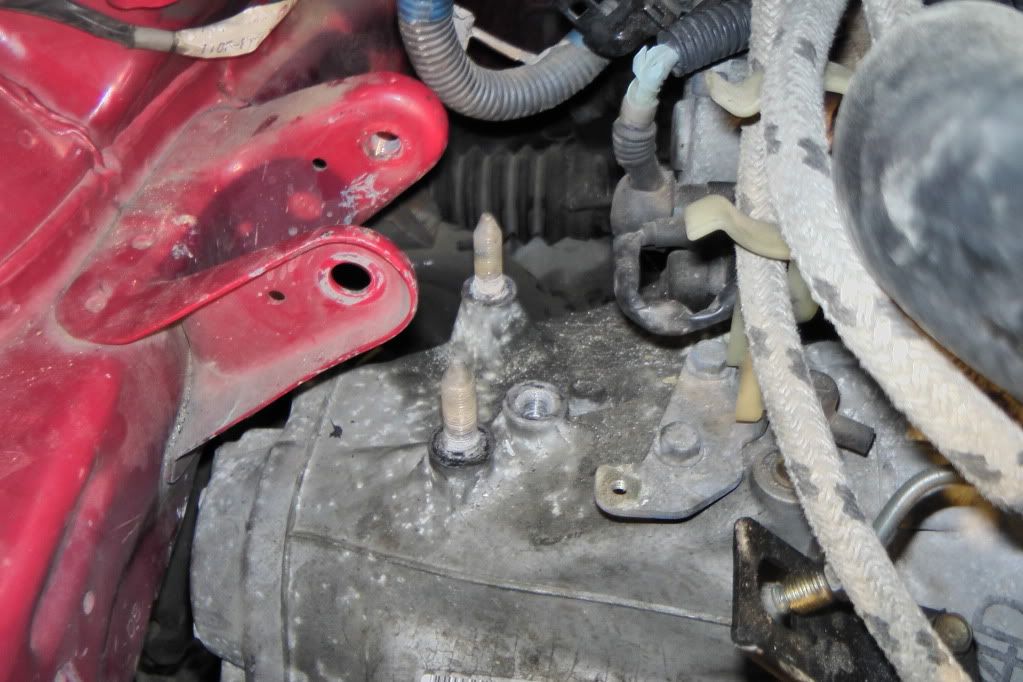

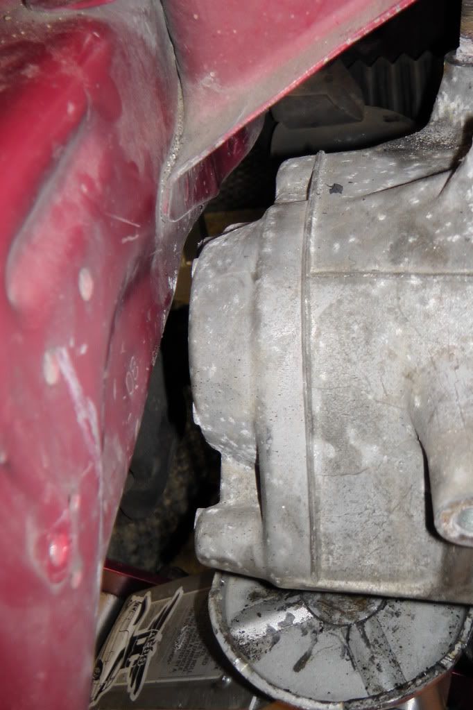

I then raised the engine using the crane and a jack under the gear box. The right hand mount slid into into spot. HOWEVER on the left hand side the gearbox hit on the rail before it was in the mount completly. I cant get the motor into its mounts before it hits the rail.

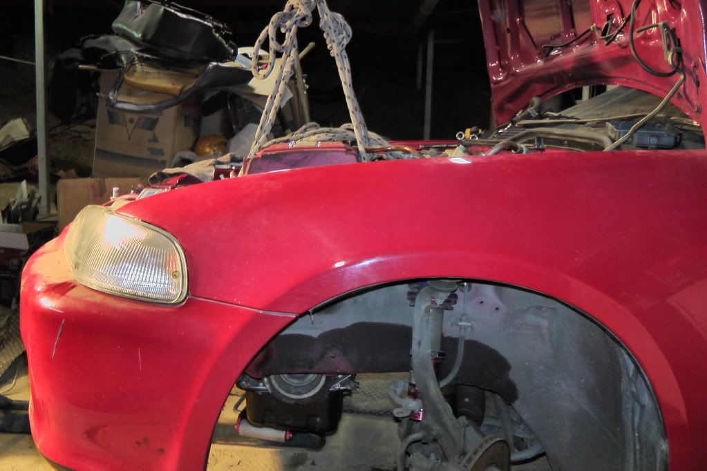

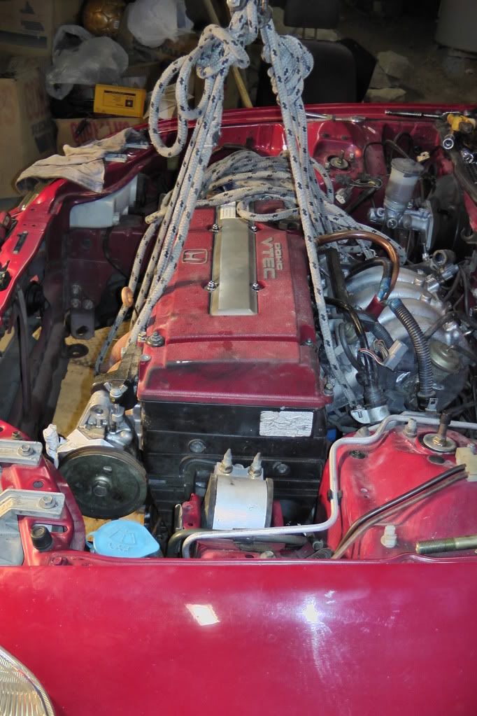

Also with the engine near the mount it looks like the motor sits very high....
You can also see that even if one side mount was in the other wouldnt line up.
With the right hand side mount in it looks like the motor is on an angle compared to the mount. As the mount is angled to the font of the car and the motor mount is straight...
Sorry I dont have a photo of the left mount in. But with the mount removed and the engine lowered about an inch it looks ok.... the gear box sitting under the rail and the motor doesnt sit as heigh...
With the motor sitting in its right hand mount and the left pulled up as far as it will go. It looks like the motor sits way to heigh... I wounder if the bonnet would close....

Is the gear box ment to slot into that litte recess on the rail ? or sit under it? ( on the left hand side)
