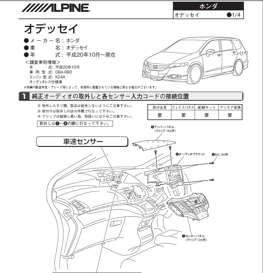

does anyone know or did it? please share with me,having truoble with it, don't know where to start with:o thanks guys!
are you experienced with installing headunit? if not probably get a pro to do it.
anyway i got this off Alpine Japan site, since i don't have a RB3 i can't confirm if it applies to our car so use it as a guide only.
Attachment 17414
:thumbsup:
Please take some pic and make a DIY guide.
thanks
Should be similar as removing headunit on RB1 if using the JDM double-din console.
