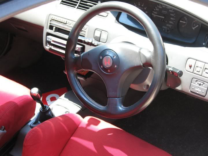

my EG is non srs so here's my upgraded wheel. JDM DC2R wheel
http://i181.photobucket.com/albums/x...DMITRwheel.jpg
the airbag of DC2R SRS wheel will NOT be deployed
