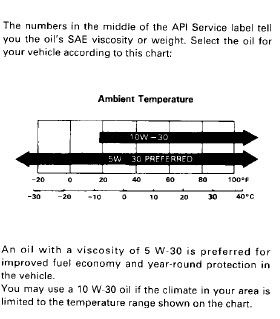

My k-series euro users manual doesnt even allow anything over 40. I'm sticking with 30 or 40 full synthetic.
http://i1087.photobucket.com/albums/...s2/integra.jpg
Reccomended oil for normal driving conditions for b18c5, should be roughly the same as the b18c7 iirc.
Using a lower weight oil will give you lower fuel comsumption readings not higher. Not every engines oil pressure should be 10 psi per 1000rpm. For example the k20a3 requires 44psi at 3000 rpm according to my service manual and the b18c5 requires 50 psi at 3000 rpm.

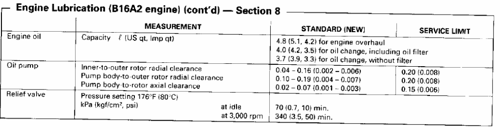

Dunno when the oil relief valve opens on the b16a but heres the service specs i could find on the b16a2.
http://i1087.photobucket.com/albums/...rys2/b16-1.png
lol, obviously I dont read what I write :thumbsup:
thanks for the specs bro :)
