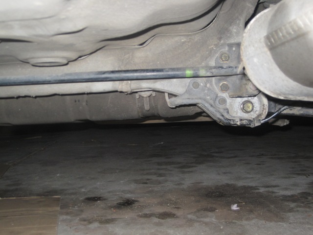

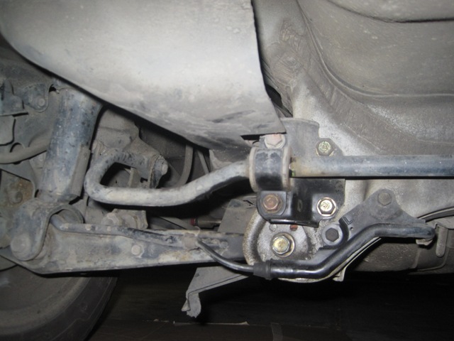

Hey guys I am wanting to install a beaks rear bar on my 94 vti-r integra. Problem is I have some sort of brake or abs line in the way from what I've tried to find out. I have two friends who have ITRs who also have this in the way. So it basically means I cant fit it flush/it won't fit.
I've looked on google and pictures of the installed product and there isn't anything in the way, they just attach the beaks bar.
Anyone know about this? If i am unclear let me know, I can add arrows to the points I mean! Thanks!
The black cable looking thing below the sway bar...that's in the way at the moment
Attachment 22230Attachment 22231
it's the ABS sensor wiring
So is there a way to install the bar? Has anyone had this problem?
Most people will cable tie the wires up.
But better option is to throw the beaks crap away
ok..i assume there is some way to remove the bolt and bracket that is attached to the wire that is in the way...cause that is chunky and was hard to move...I shall have another look soon...! Thanks so much for your help!
Once you unbolt the ABS wire you can get quite a bit of free play and move it around man.
ahh and that is when i zip tie the wire up away or something i think?...yeah i will have a go thanks i shall work it out

From memory I just bent the brackets a little and never had an issue in the years since fitting it. The tie bar isn't meant to make a difference you can feel. It just helps provide some strength or integrity to the chassis when a thicker sway bar is used such as the JDM ITR 23mm bar pictured. An ITR has one fitted stock as well as a thicker subframe in this section to start with.
