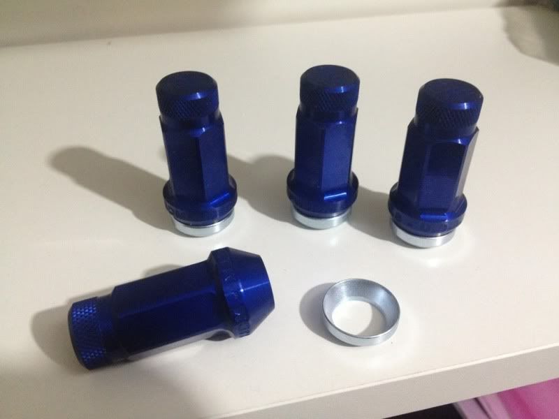

You can buy adapter rings to use taper on acorn and vice versa
http://i271.photobucket.com/albums/j...8781506293.jpg
Aw didn't no that.
Where from champ
The answer is to change your rims then get taper nuts
Online or one of the traders here had them,cant remember who though lol
cartoon sells them
