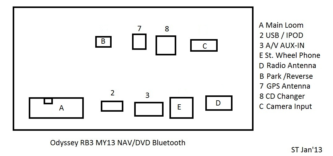

The MY13 now comes with DVD/NAV/Bluetooth as standard, and it's a bit different from previous years' models.
Attachment 23615
There's quite a bit going on in the back of here, so I'll post updates as I discover the mysteries within.
The main stereo loom (Connector "A"), whilst similar to previous models, is slightly different from anything I could find on the net:

This drawing of the plug connector came from somewhere else on here, but the numbers are back-to-front from the Honda service manuals:
Attachment 23635
