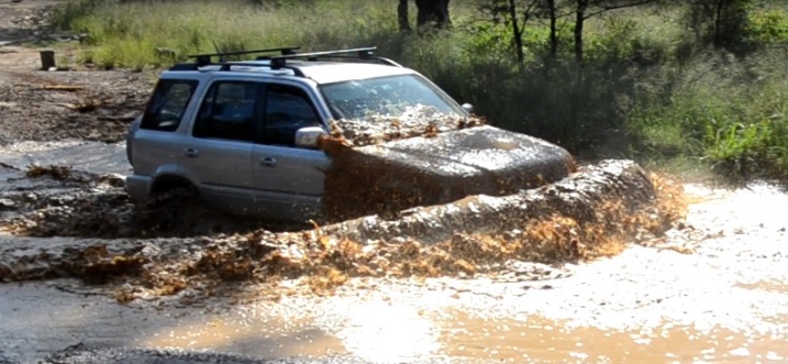

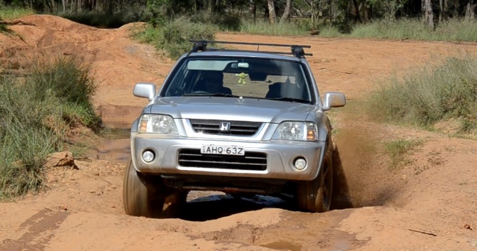

Yep i used King springs raised around 50mm, Also im running Dc5 rims with 235/60/16 tyres
Attachment 26744
Attachment 26745
The tyres in that photo are these. http://www.kumho.com.au/blog/product...ture-apt-kl51/
Next set of tires ill be using are http://www.jaxquickfit.com.au/tyres/...0R16#read-more
Yep it will fit 235/60/16 on dc5 rims or rim with less offset!
