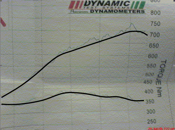

I NEED TO VENT MY ANGER. I'M NOT SAYING ANYTHING. IF YOU GUYS SEE WHATS WRONG WITH THIS YOU'L UNDERSTAND.
http://www.members.optusnet.com.au/s...zzz/farout.JPG
dude it would help if it shows the whole address lols
cant read the last bit..
missing something?
it ain't a smooth line?
That Was Dyno Tuned Today And Thats The ****en Result -_-
you creased the paper so now itll look stupid if you frame it?
its only showing torque?
and it looks so unstable low n crap ?
yeah something like that. tuner bodged the whole job -_- and then continue to blame it on my car. How is a smooth curve got to do with my car? His the fcuekn tuner its his job to smooth out the dam thing.Quote:

honestly the tune doesnt look THAT bad.
it spikes alot - tuner didnt bother to put smoothing on, this arises just from the dyno itself, how well it spins ect, much more detailed then that.
Power past ur ecu rpm - bad calibration, will arise from the factory tacho being off.
the no large increase in power due to high cam(vtec) - this is due to him doing a good job on the crossover rpm, idealy u dont want a sudden jump of power.
Getting an ecu aint all about gaining power, its about gaining drivability, how does it drive on the street? and i am serious, unless u got some stage three toda cams or some hardcore shit u dont want a jump in power due to high cam crossover.
Show us a pic of the AFR, hows about base vs final tune graphs and then i shall make a decision.
First off i thought the point of a tuner is too smooth off the curves? I could be mistaking but i was under that impresssion. Power past ecu rpm? Aint got nothing to do with the tacho. POWER FC is SET AT 8888 thats what its set at you can check by scrolling through the hand controller. Its obvious by readin the dyno sheet that is says max power is XXX@9XXX. I didnt show the rest due to legal reasons. As for the no sudden jump. And yes i am expectin a jump. There should be a slight drop at 7.2rpms as it jump to high cam crross over then a gain. I'm not stating mod but you can assume what you will why im saying this. As for power? well **** that was a total dissapointment. Both my friends dc2r got dyno'd same work shop STOCK ecu both have done, headers, exhaust, intake and thats it. I've done that and more plus a power fc thats meant to fully tune that and i got basically same figures as them.Quote:
Originally Posted by CUL8R
Driveablitiy wise the idle was set way too low which was fixed by a second tuner inspecting the damage . Honestly speakin car does feel smoother but has way less power then it was before i tuned it. Top end revs drop out for some weird reason and there more and more. I can bitch all day.
look theres a setting on the dyno software to smooth curves. have a good look at urs heres wat it woulda looked like if he pushed the button
http://i14.photobucket.com/albums/a309/CUL8R/smooth.gifreally it aint bad.
ur friends prob suffer from hesitation on part throttle.u wont coz u got a non stock ecu
dude post up AFR and BASE/FINAL tune plots with the company blacked out with a square so we can see it all, this looking at one plot is very narrow minded.
i know my tuner well and i actually get a chance to sit in the car and speak to him as he works, u are never gonna get a perfect linear power curve like the smoothed pic i showed, but the smoothed pic is a good indication as to if its any good or not.
did ur tuner change vtec crossover? coz looking at it theres two clear distinctive gradient line of power, but i cant see what rpm it represents

NA power delivery is spose to be linear, hence a smooth power curve!
this one jumps around like its on spd - its not normal or tuned properly by any means.
my turbo graph is smoother than this, and my tune was only an average one!
dyno graph update. only thing you cant see is ont he left hand side which is power.
My personal advice dude, change your tuner ASAP.
because there is a button on the dyno program which smooths the line out more.
i am gonna try and see if my tuner has my original final tune and then smooth curve.
a dyno gets a graph from voltages and junk, these figures do not come perfect so u need to have a line of best fit or somethign to smooth results. when u measure things like current drops over resistors or soemthing why is it that ull take 5 readings then average em? because ur reading will never be perfect unless u choose to spend excerssive money on accuracy. dynos are relativly cheap, 50k, to think they are gonna measure things absolutly perfect would be ignorance
this has dips over prob what i can see maybe 1hp over a 50rpm bracket, think about the scaling here.
dips in the wrong place. vtec is set at 7.2prms. Theres also a dip before 4 rpms that goes thru to 5 rpms for no reason. Uncharacteristic.Quote:

ok heres another addition for knowing technicalities with dynometers, people are looking at the results with too much a narrowminded attitude, not considering any important factors.
what mashimaro has given us is a picture of an elbow and asking us to say the girl is ugly. we need to look broader!!! we need to see more than one snipit before u can say this guy cant tune!
http://www.mainlineauto.com.au/produ...OWACCURATE.PDF
seeing the only thing there that i wouldnt be happy with is the torque hole at about 4500, but i say that assuming my AFR was perfect and i got a decent base/final gain
are you sure u dont have crossover at about 4500-5200???
u go out and push it and listen to the engine, check if at 4500-5200 u can hear the vtec solenoid click, then ull prob build oil pressure then high cam will propperly engauge?
at what point is vtec now? the tuner would have to of changed the point for tuning purposes....it does look like itll be at about 5200 rpm
7.2 as stated.
Why on earth would vtec be set at 4.5? We tried settin it at 6 and it was dropping.
After tuning cant hear vtec at all now. I'm onli takin it off the power fc hand controller.

knock of 35 is OK, and means the tuner kept timing adjsutments 'safe'...
it doesn't look that bad to me... yah, there's a dip in torque at 4kish that's less than ideal, but I've seen much worse.
the jaggedness of the graph could really be something as simple as what the smoothing was set to on the dyno output. A dyno output will never come out super smooth... there's always a certain amount of smoothing done in the software make the output "pretty".
There shouldn't be any jump in power at 7200rpm(which seems awfully high to me to have vtec set to, but that's just me) or wherever vtec is set to engage if the motor is tuned properly. A jump in power at vtec means the car is making less power than it should.
What really need to be done to show the quality of the tune is for you to show a before tuning dyno, the after, and an a/f printout, not a shot of sorta part of one graph.
Also, having a dyno show readings after peak redline isn't that rare... remember, you're spinning a big heavy drum, and accelerating it. It's going to continue to increase in rotational velocity after the clutch is disengaged... this is called physics.
