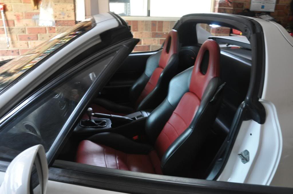

yeah, they fit but with a bit of DIY work..
you have to remove the floor pan of both your original crx and s2000 seats, and swap them around.. and the recliner too..
alot of fiddling around, but definitely worth it :thumbsup:
http://i28.photobucket.com/albums/c2...000seat032.jpg
http://i28.photobucket.com/albums/c2...000seat033.jpg
i have more pics, but it's gonna take me a while to find them, and i seriously cbf :p
looks quite nice tRipitaka !!
Oh nice, that looks sweet, i definatley doing that!
Tripitaka - that looks awsome - takes the 'sol interior to the next level !!

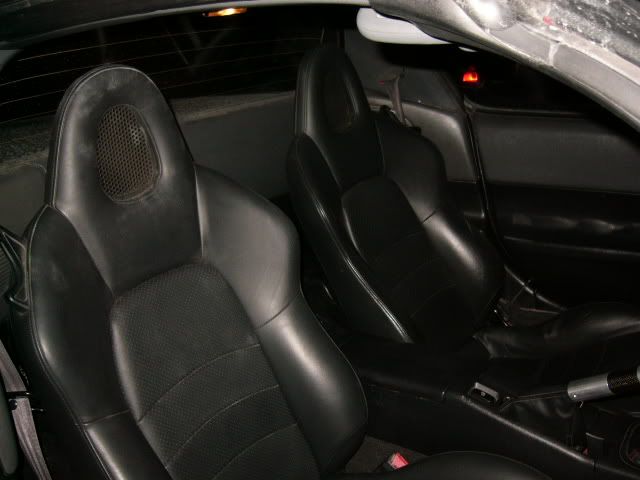

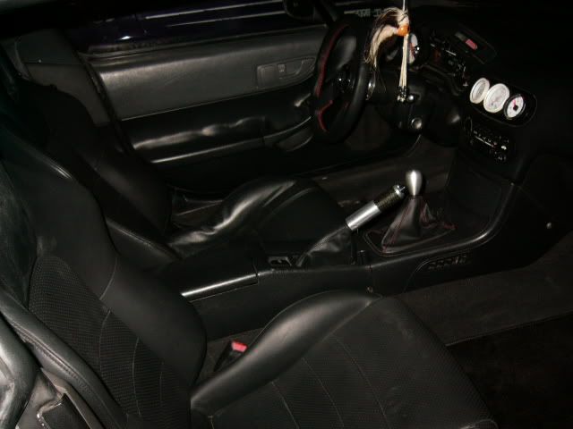

Ill post up some pics of my del sol with S2k seats 2night
snoop can u measure the s2k seats, how wide and tallness???
i'll try tomorrow get some diemension for ya.
In the mean time.
http://www.redpepperracing.com/galle...02860+copy.jpg
http://www.redpepperracing.com/galle...02861+copy.jpg
http://www.redpepperracing.com/galle...02871+copy.jpg
http://www.redpepperracing.com/galle...02863+copy.jpg
http://www.redpepperracing.com/galle...02876+copy.jpg

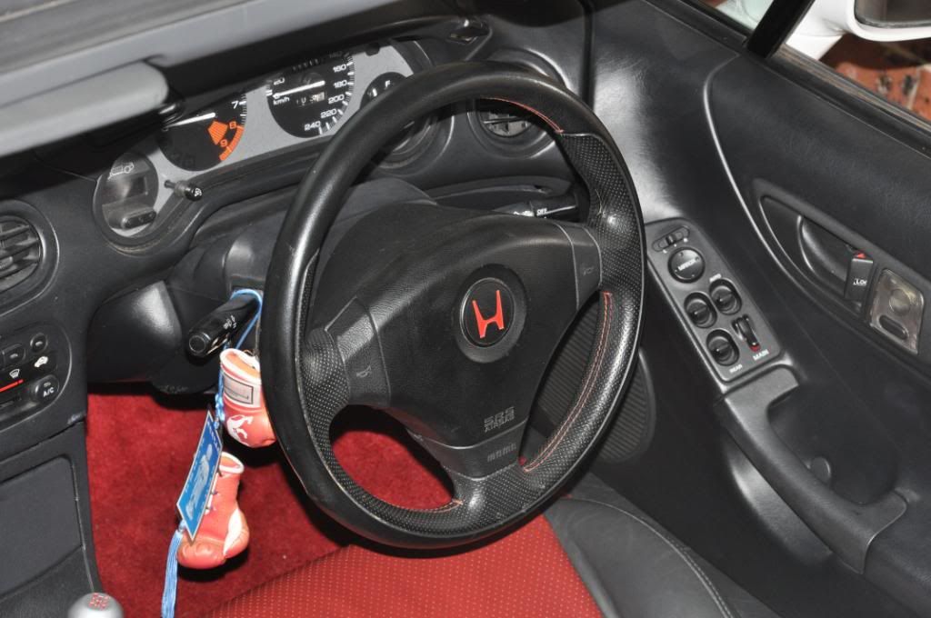

u ****s have nice del sols. does that type r steering bolt directly on?with srs function?
yes it does bolt on action from dc2r

so does the 98spec DC2R wheel
i heard that the airbag wont fuction properly on eg's SRS
did u manage to sort that out? *O*

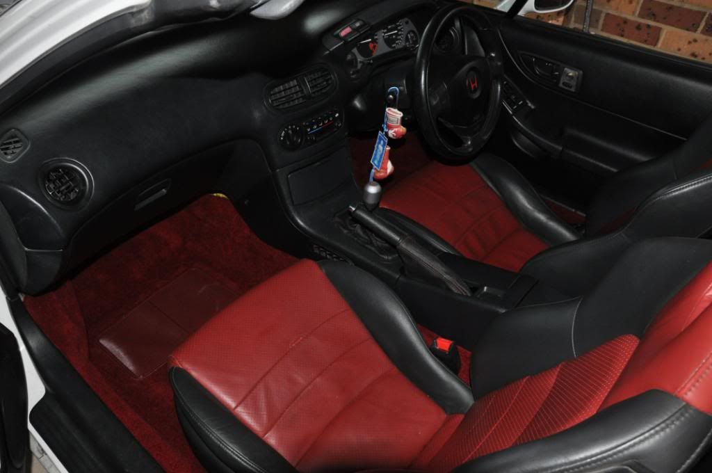

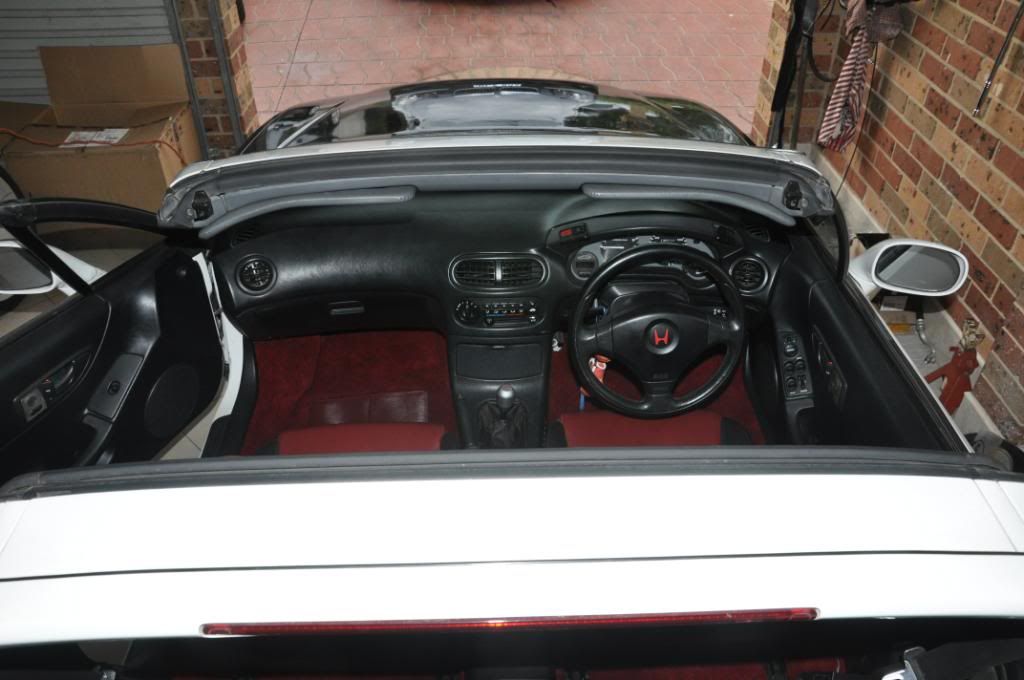

http://i30.photobucket.com/albums/c3...i/CrxSeats.jpg
these are my actual crx seats trimmed in leather to look like the 2 tone s2k seats
how much did it cost u to retrim it?
i always prefer del sol seats to s2000 seats
for better comfort (Y)
$1900.00 for both
