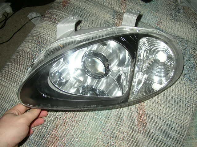

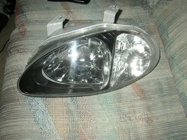

For example, here's a set I did...
the "stock" light(actually an aftermarket light that's been painted and such, but it's a normal halogen refelector light)
http://i28.photobucket.com/albums/c2...2/P1010071.jpg
the retrofitted light(using a projector assembly from a bmw 3 series)
http://i28.photobucket.com/albums/c2...2/P1010072.jpg
the funny thing is that if you keep a watchful eye on ebay and such, you can generally get an oem set up(projectors, bulbs and ballasts/ignitors) for less money than a low quality aftermarket drop in kit would cost.
Vastly superior performance for less money... hard to complain about that.
