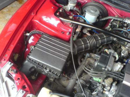

well after all that, the next step is to take off the top of the airbox like so and remove the air filter element
Attachment 2146

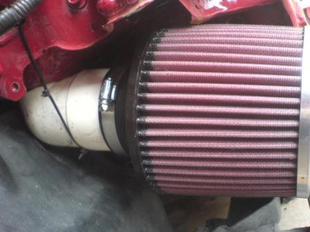

next is to find a pipe that will hold the pod and be conected to the end of the airbox, its up to u what u use,
but i was 'el cheapO' and use a $5 piece of plumbers piping
mount it inside the guard to the end of the airbox like so
Attachment 2142
use zip ties to hold it in place and so it doesnt move

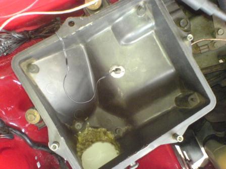

there is a hole to where the resenator was connected to the airbox

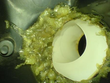

next step is to plastic weld or epoxi the piping to the end of the airbox
Attachment 2145
took me a while to do this step
i know, i know it looks sh*t, but whos gonna see it

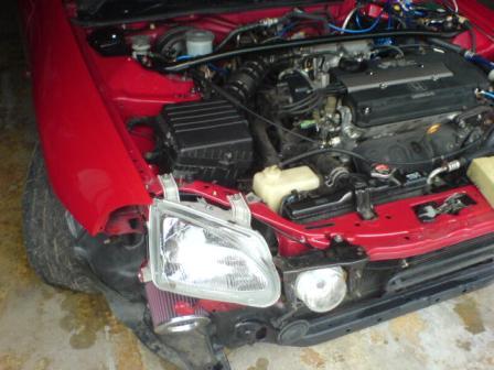

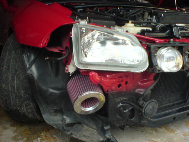

and u're end result should look like this
Attachment 2143 Attachment 2141
note: pod under head light

comments: if i was to do that again i would of painted the piping black to look like
the rest of the intake system, doesnt show much but if u look carefully u can see the white piping
