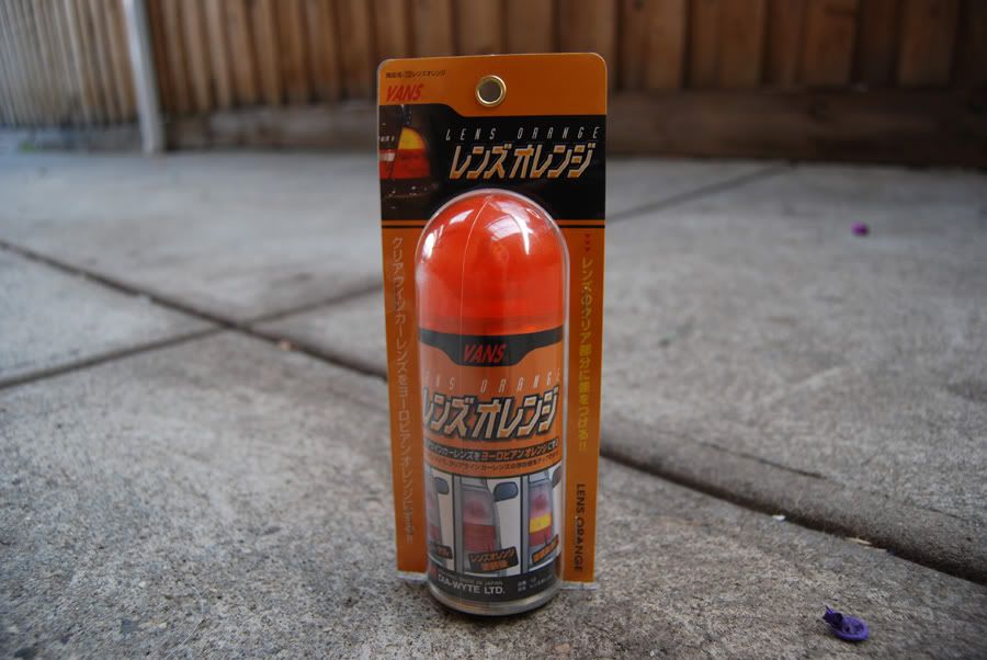

Required: *Amber lens dye. (i got this from autobarn)

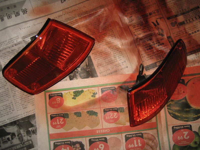

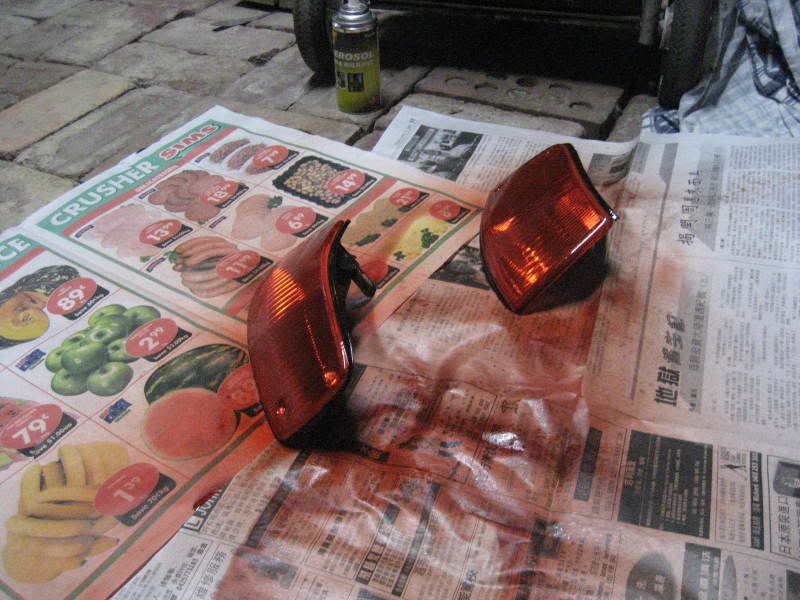

5. now we can start painting. If you want you can give the inside a quick clean but i didnt bother. shake your lens dye really well and apply even lights coats leaving 20 or so minutes in between coat. when tac dry. place it over your housing again to reveal it true colour.
6. when ur happy with the depth of colour apply silicon to the edges make sure you get a decent amount and no gaps and hold it in place ( i wrapped in in a towel tightly)
7. repeat for other lens matching the colour to ur 1st one and refit them to your car when dry.

mine turned out better than i had ever hoped oh and dont go washing ur car straight away eather let them dry for at least a day.
