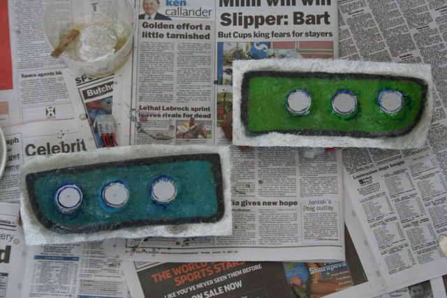

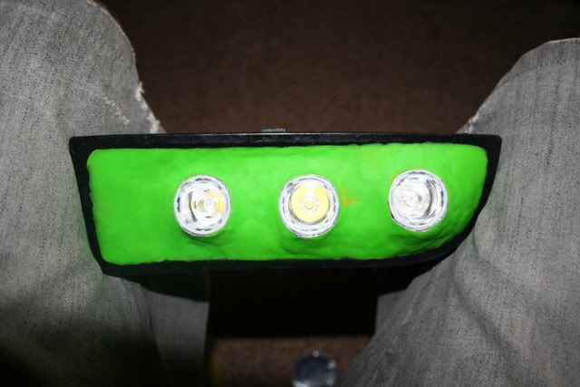

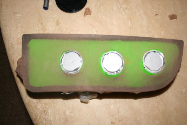

I had to cut the heat sink in half so that it could be fitted in both moulds. Then I went ahead with a small angle grinder and hacked out the moulds and fitted the heatsinks in. Next step was mounting the actual LEDs themselves and the collimators (or lenses..) over the top.
http://img187.imageshack.us/img187/1954/img1020nw7.jpg
Shrouds were made to hide the sides of the collimators.

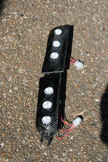

http://img187.imageshack.us/img187/5340/img1019fd6.jpg
LED's were wired and harnesses made.
http://img187.imageshack.us/img187/8306/img1013gc1.jpg
