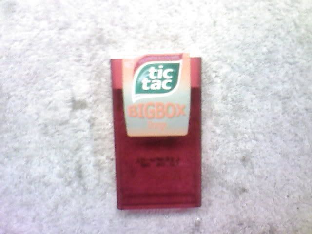

Orange Tic Tac Box

6. This is the hard part, take the label off a orange Tic Tac box and clean any residue and then trace out the size of the hole in the clock outer casing where the numbers shine through. Then cut a piece of the box to fit, I used a very sharp Stanley knife and it still wasn't easy to cut without snapping the plastic.
