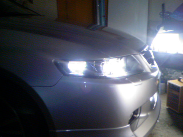

excuse the quality of the pic, taken on my phone...
ill try get better pics later on... as you can see, it gives a fairly destinctive white line effect (looks better in real life)
http://www.ozhonda.com/forum/attachm...4&d=1191687580
cost $30 materials for both sides... fully sealed globes using the original holders and hot glue gun :)
it matches the HID colour perfectly... which is what i wanted

r those 6000K or 8000K HIDs?
Very nice! That would make it about $50-60 to make in total? And then plus shipping. :)
yeah thats about right... i couldve done them cheaper but because i was experimenting i purchased more stuff than i needed lol
the hardest bit is glueing the tube into the holder on the correct angle so it fits in and points straight down the light... (i had to make and remake it a few times, found it easier to put it in with the glue still hot/goey so that i could mould it into place)
nah theyre still stock 4700k HIDs im thinking of getting 6000k tho...
i could make them for people, but i use the original globe holder, so youd have to send that to me, and they do require you to solder onto the park light wireing
oh and yeah they are bright enough :) ALOT more light output either side of the car, and about the same light facing forward...
someone willing to send him the parts, so we can all get a DIY? lol
^^ Labour cost is much higher than parts. :)
Sounds like my last Honda Dealer Car Service x10 :p
Those fluro's look good on the HID Euro's, but they may actually be brighter than the Halogen Euros lolz
Either way, you might get defecting have super bright parkers, bright light is supposed to channel down onto the road.
From his pic, the parkers are not blinding, should still be legal.
