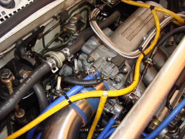

Ok soo today this is what i came up with. This is before i pulled apart the IACV:
http://i101.photobucket.com/albums/m...c/DSC03260.jpg

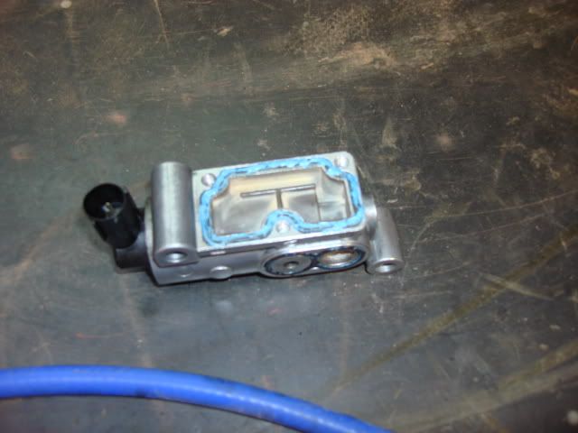

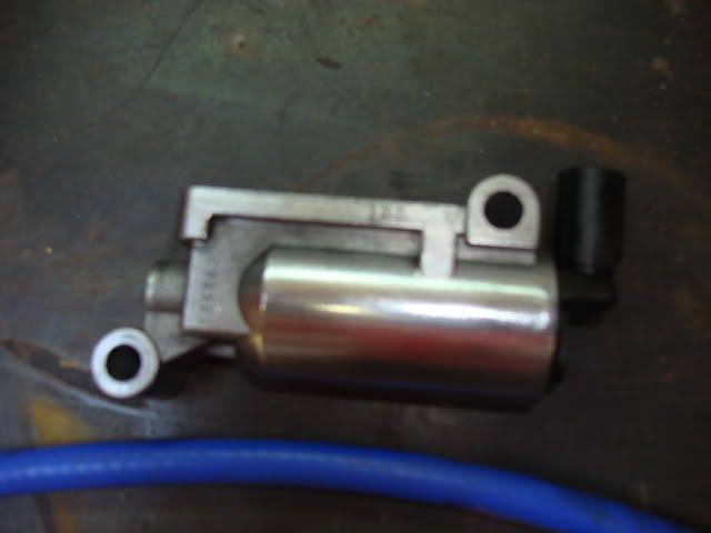

Now ive cleaned it up. I got Throttlebody cleaner and left it soak submerged inside for about 45 minutes. Pictures below:
http://i101.photobucket.com/albums/m...c/DSC03261.jpg
http://i101.photobucket.com/albums/m...c/DSC03262.jpg
http://i101.photobucket.com/albums/m...c/DSC03263.jpg
http://i101.photobucket.com/albums/m...c/DSC03265.jpg
I also Sanded back some of the rust on the back water casing so it would sit nice and flush.

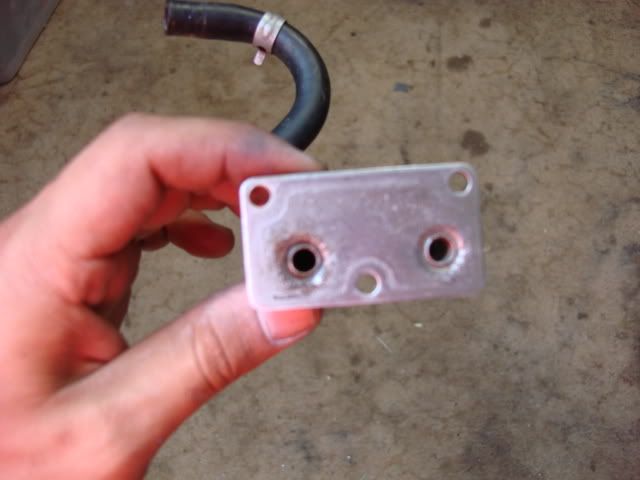

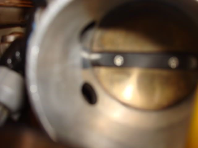

Then when i put it back on still nothing. Reving up to 5000rpm idle. I read up on the net that if you plug these two holes in the picture below it should sit at stock idol which is what the screw is set at.
http://i101.photobucket.com/albums/m...c/DSC03268.jpg
The top hole didnt make any difference but the bottom one is sucking all the air threw into the intake so where ever that air is coming from is the problem. Which i seem to think its the IACV. Heres a movie below to show you what i meen.
http://i101.photobucket.com/albums/m...h_MOV03266.jpg
If anyone can tell me which hole goes to the IAVC and which doesnt that would be great. Because if that below hole is the IACV even after cleaning it twice like i have it has to be replaced.
Ohh also one thing i did check is the Voltage coming out of the sensor wire. it was 2.2-2.5 volts on Accessory i didnt get a chance to start it but i just wanted to make sure the thing was showing some voltage to check to make sure the wire wasnt broken.
the hole that you were blocking goes to the iacv, the water port part is just for cooling, inside it there should be like a white plastic spring like thing (like an accordion) with a metal rod through the back of it, when you look into the holes you should see it and you just need to see if it moves freely when you push it, be gentle dont rip it. when your car is cold it should open to rev a little higher, when worm it should shut or nearly shut, it seems like your is stuck open.
I haven't attempted to dismantle an IACV. I'm sure you could ensure a more thorough clean if you did, but there may or may not be issues when re-assembling it...??
The water lines are irrelevent to your problem. They don't cool the IACV, their only purpose is to warm it, I assume for the same reason there is water heating for the throttle body, i.e. to prevent icing up in freezing conditions.
The IACV works by drawing air from a port that starts just before the butterfly, air then passes through this port (which is inside the plenum casting, but closed to the plenum chamber proper) to the end of the port which exits at one of the ports in the IACV. Air is then metered as required (as 'instructed' by the ECU) through the IACV and out the other IACV port into the plenum chamber and from there into the cylinders.
Ok dude i fixed it...the Lower port that i blocked went to the FITV. not the IACV. but i opened it back up and the thred seems to be a little damaged so this afternoon i went and picked up a new internal part from a wreck put it in screwed it up and DONE!! works.....1100RPM HEAVEN....
