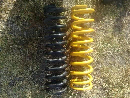

Aim: To replace front springs
Tools and parts: Hammer, ratchet, 10mm 12mm 14mm 17mm spanner, beer, jack stands, jack, and a lot of
swearing, spring compressor, patience and maybe some other little stuff.
Steps: have about 22 pics or so
Additional information: SAFETY FIRST! & Good to have a mate to be there to help if anything goes wrong.
THIS IS BEING PERFORMED ON MY ED9 '89 CRX
and also i don't know specific names on the parts but just trying my best :)

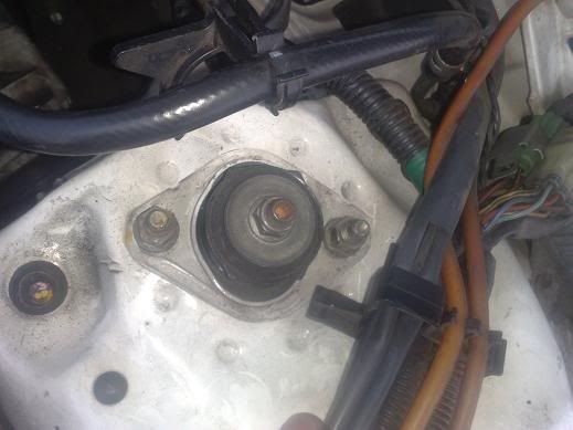

http://i278.photobucket.com/albums/kk88/sidzcrx/001.jpg

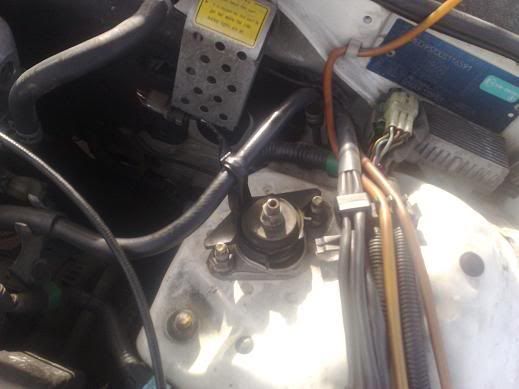

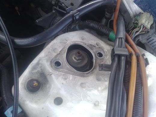

Pop the hood and locate the upper mounting bolts & nuts n stuf

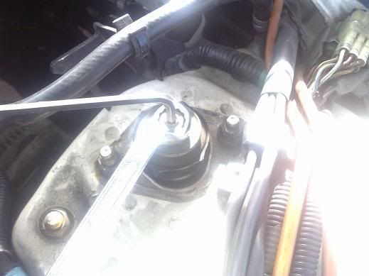

http://i278.photobucket.com/albums/kk88/sidzcrx/020.jpg
Use an allen key (don't know what size but i found one that exactly fit, from the shed) and spanner thing to loosen
up the spindle nut on the shocks. Just a couple turns will do fine. DO NOT UNDO IT ALL THE WAY!
Then move on to the nuts on the side and just loosen those up a bit too, but do not take it all the way off.
Jack the car up and support it on stands.
