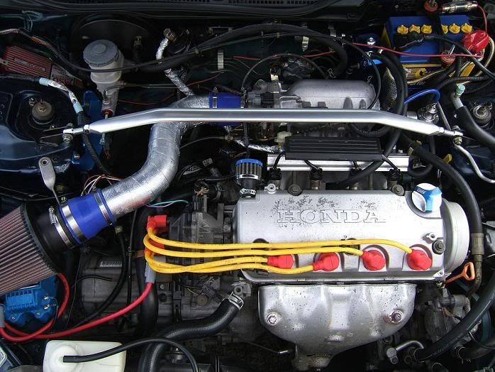

Can't I add a filter or something between that hose?
http://i99.photobucket.com/albums/l2...2/DSCF1297.jpg
What's the little filter doing in the rocker cover hose point?

You ya don't need the intake to rocker cover hose connected then and just add a breather works fine?
How did you block the intake piping hole?
Turbo's done like only 10,000 kms max and was brand new
It's an old pic...I've since removed the small air filter and put the hose back from the valve cover to the intake arm because I was told by 'Transzex/bone' off d-series (you know who I mean Luke) to 're-connect the hose if you want your engine to last' and he knows his stuff alright.

can you post a pic of ur engine bay luke?
mine had the same issue
unplug the line from ur valve cover to where the intake is... put a breather at the end of the hose and block off ur intake
clean it all up and see if your getting any oil then

There are quite a few different opinions on how to plumb the PCV system for a turbo application. As long as the crankcase is not being pressurized by the intake charge pressure and the crankcase has some way to vent pressure you'll be in good shape. Probably the worst thing you can do is to add a valve cover breather filter to the fitting on the valve cover and retain the plumbing for the stock PCV valve. This would force the crankcase to vent through the valve cover breather filter. Many of the popular turbo PCV options include the use of a catch can. The catch can has internal baffling that separates out more oil vapor from the system. This is important because oil vapor effectively lowers the octane rating of the gas you are using, making detonation more likely. The catch can of choice is the Moroso Dry Sump Breather Tank Moroso part# 85470. The catch can needs to have 2 fittings on it. One is provided by way of a port on the side of the can. The other must be added by inserting a grommet into the top of the can (Help! PCV Grommet # 42048 for a Ford Econoline Van), and then a barbed fitting into the grommet. See picture below.
Hope that helps.
Surely I can just add a catch can between the pre-turbo intake and rocker cover?
