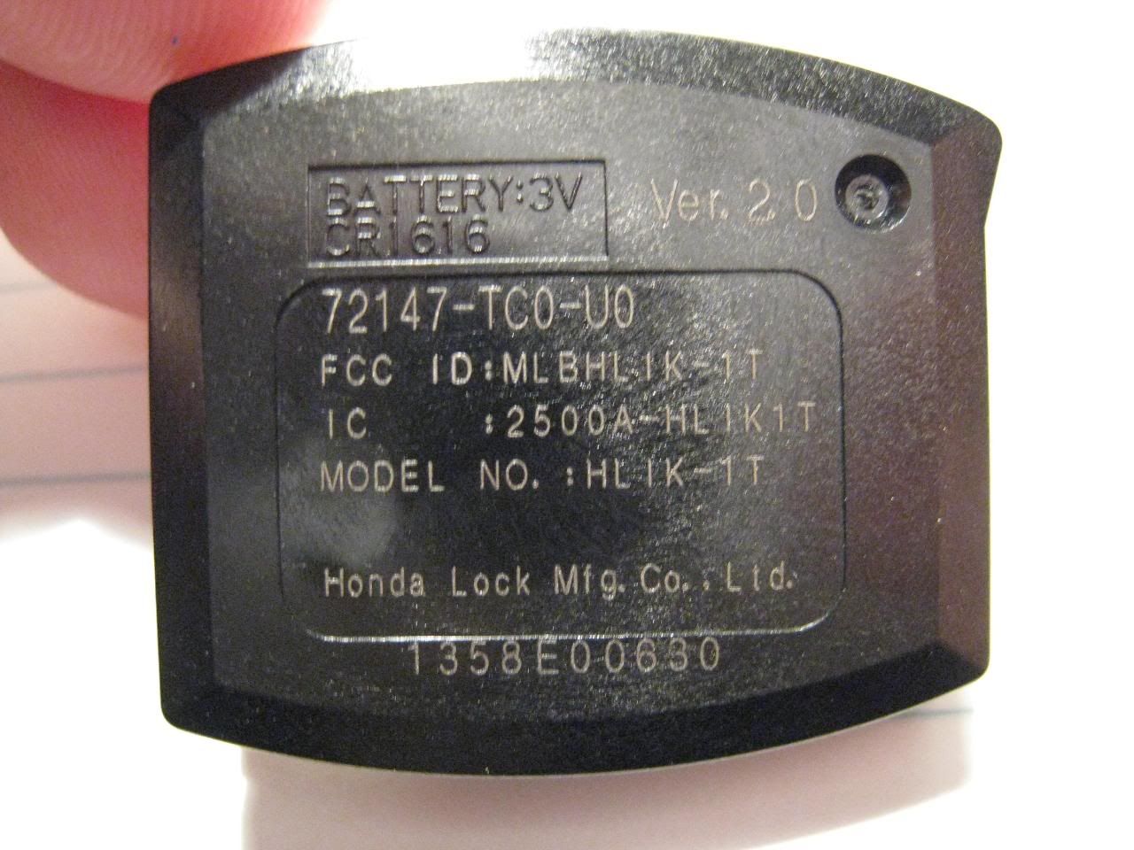

the only thing you should worry about is the FCC and IC numbers if it matches its then no problem sometimes your lock would work but wont start the car then you have to take out the immobilizer bit form your old key and put it into Ur new key
The FCC ID for this key is MLBHL1K-1T. The IC number is 2500A-HL1K1T.

did you check the FCC & IC ID's? if they match then you shouldn't have a problem....

Where can we check the FCC and IC ID? there's nothing at the back of my key. I called the dealer but the person who answered didn't even know what FCC/ic id all about, he was just saying about a range of frequency etc (I didn't note down) which by the way making me even more confused :(
let me briefly explain
FCC/IC ID is located inside your remote on the sticker

open up on your key...and it should be on chip that falls out.
and see if you can match it with:
FCC: MLBHL1K-1T
IC: 2500A-HL1K1T

Here's a pic of the Australian CU2 stock key.
http://img.photobucket.com/albums/v3...k/63be8144.jpg
It seems that this one has the same FCC ID and IC codes as the TSX (CU2 TSX anyway).
