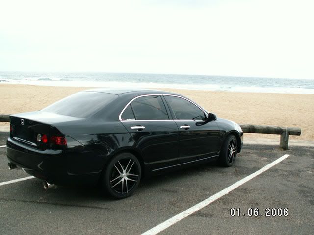

did it yesterday. comments =] dont hate
http://i4.photobucket.com/albums/y11...C00845copy.jpg
http://i4.photobucket.com/albums/y11...DSC00843-1.jpg
http://i4.photobucket.com/albums/y11...C00847copy.jpg

lol i ahte it.......man why????? nah haha joking...that looks sexy....good work....gona tint ur headlights aswell?
lol nah im not hardcore enough to tint the front ones
should get a gloss make it gloss finish matt doesnt match
rofl i tinted my front ones but stuffed it so when i have time i am going to respray LMAO!
talk about me wasting my money.
nice job mate. nice looking.
yeah i was thinking of a clear coat but dint bring enough money ^^
pooo nvm eh maybe this weekend:thumbsup:
lol yep. hrm crapadaz if ur in melb wunna do an eyelid for the front :D
Looks sweet.
However I would have just tinted the inner lights (the ones attached to the boot) to keep it legal. Its a requirement to have red at the rear when the brake lights are not on.

Darkness looks fine but you really do need to put a decent quality gloss clear coat over the top. Looks cheap and tacky as it is. Once you hit it with some clear coating and give that a polish so it's as shiny as factory then it will look good.
To remove spray-on tint from plastic lenses what you want to do is WET SAND. I would strongly advise against using any chemicals to attempt removing it, you are very likely to ruin the plastic.
Gently wet sanding with a very fine paper soaked for at least a few hours (1500/1200/2000 grit - try the least abrasive first) and then polishing the plastic will restore it.
