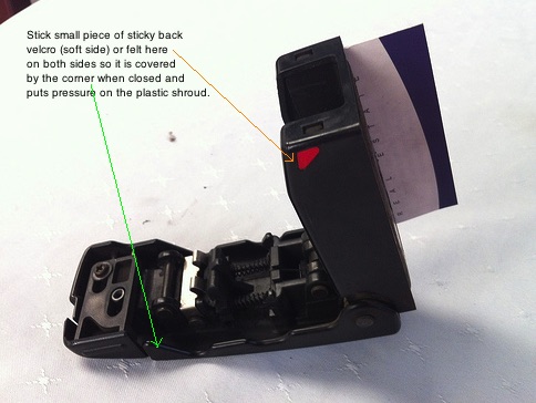

step 4
slide the business card from underneath until it goes as far in as possible
http://farm9.staticflickr.com/8426/7...08db84c2a7.jpg
step 5
use the knife or box cutter to trim off the card leaving the cut piece wedged between the plastic and metal. Do this to both sides to have 2 pieces of the business card on each side between the metal and plastic.
