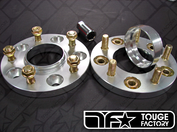

So once you have checked to see if your studs will clear your wheels, you can go ahead and get a floating bolt on spacer. These should be kept to minimal sizes, ie 10mm. Any larger and you should be looking into getting a hubcentric bolt on spacer.
Floating bolt on spacers CAN be turned into hubcentric bolt on spacers, you just need the right centering ring. for example here:
http://www.tougefactory.com/ebay/ichi2.jpg
