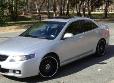

Here are the before pics:
http://i.imgur.com/GD5HL8A.jpg
And after:
http://i.imgur.com/GMCtA5P.jpg
http://i.imgur.com/MOBPc5S.jpg
the stiffness is set to 8 clicks front, 10 clicks rear.
The height is 115mm front and 125 rear (between thread locks).
