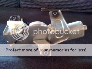

3) locate the rear wiper motor at the top right when looking at it and there are three more 10mm screws holding on the rear wiper motor. undo all three and it should come off quite easily.
http://i591.photobucket.com/albums/s...IMG_0430-1.jpg

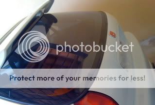

Now you've got an empty hole in the back of the hatch without the wiper motor screw head sticking out.
http://i591.photobucket.com/albums/s...IMG_0432-1.jpg

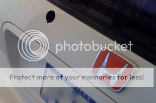

Pick yourself up some $3 CHAMPION rubber blanking grommets from Supercheap and slot it in. Now i completely understand that this isn't an OEM delete plug but if people are sad enough to steal it, well you've got 2 extra rubber grommets in the packet.
http://i591.photobucket.com/albums/s...IMG_0433-1.jpg

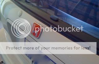

I actually went on to colour code mine to white because i wasn't digging the black on white look. but it did look that extra bit JDM though :D
http://i591.photobucket.com/albums/s...IMG_0436-1.jpg
http://i591.photobucket.com/albums/s...IMG_0434-1.jpg
tested for leaks and no problemss soo farr!!
