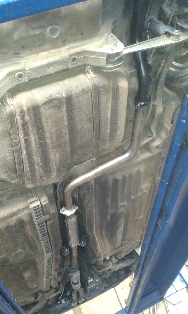

Custom Short ram intake + cold air feed - open system because of rain/water/Port matched X-Force 4-2-1 headers/2" custom exhaust (2 press bends on a mandrel bent system for increased back pressure/low end power,no res,hollow cat
