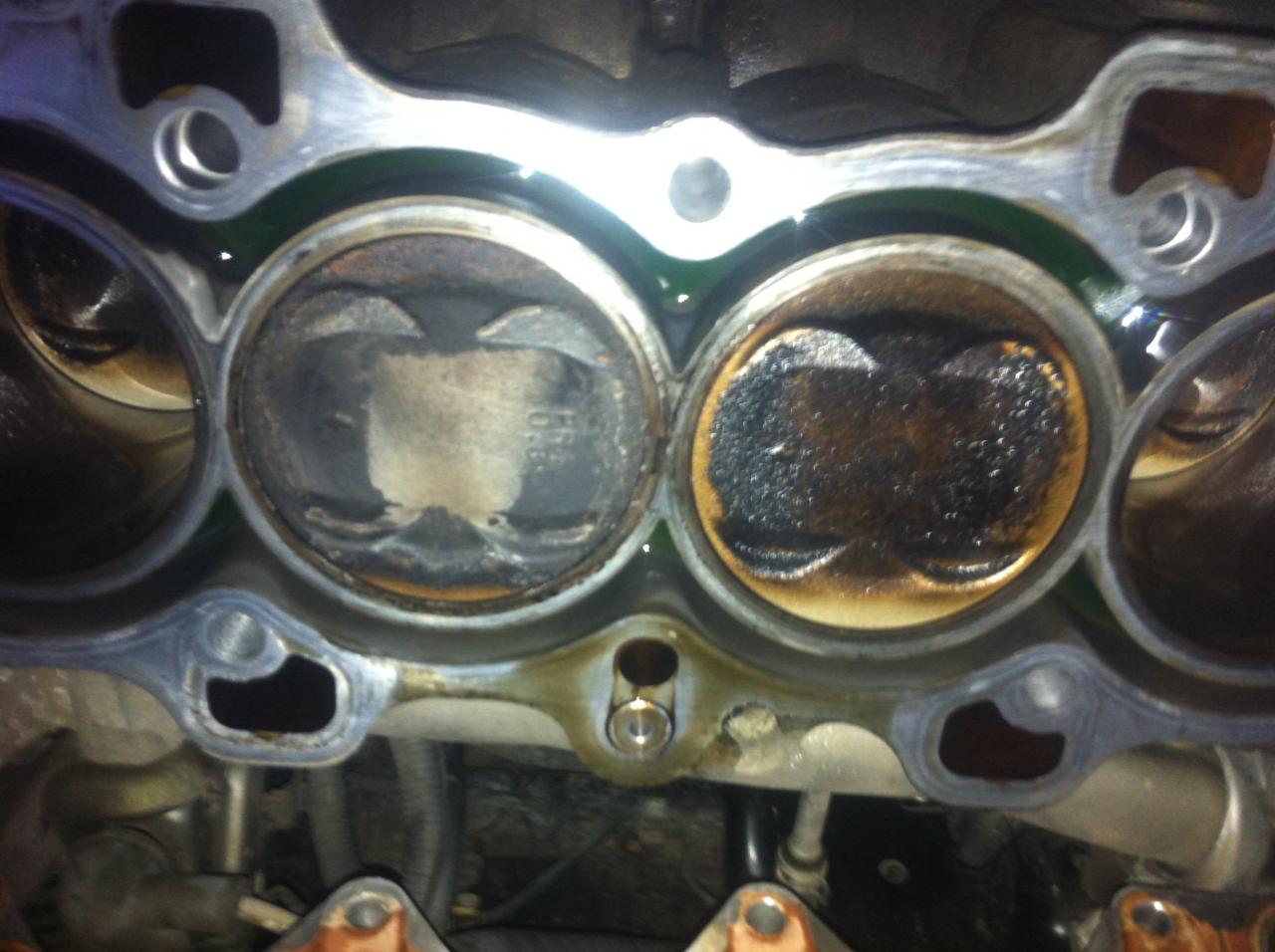

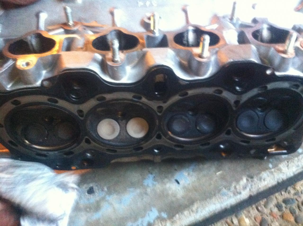

I completed a compression test which showed that cylinders 1,3, and 4 had compression of 180psi and cylinder number 2 had a low compression reading of 150
Upon disassembling and removing my b18b cylinder head, i noticed that 2 exhaust valves on one cylinder (number 2) were of an off white colour compared to all the other valves being a charcoal colour, and also the piston in this cylinder (number 2) is dry compared to the other pistons as show in the picture also.
Attachment 23733Attachment 23732
I'm unsure what has caused this problem and what will need to be fixed/ replaced to fix the problem
