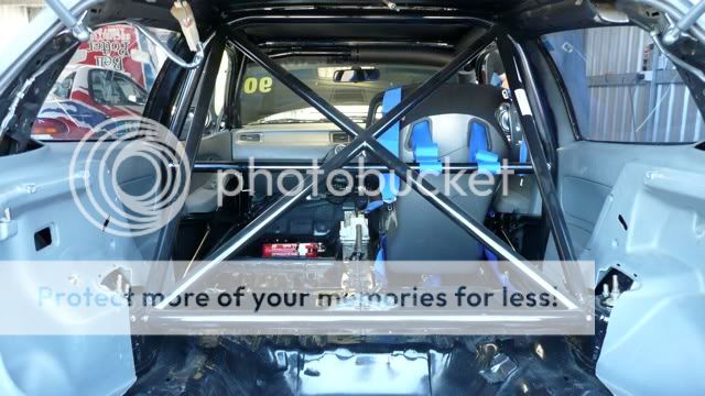

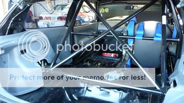

I'm always impressed by quality workmanship and this is no exception. Congratulations on a job well done!
Any more photos?
Similar bar work in my old racer:
http://i148.photobucket.com/albums/s...IMG_0003-1.jpg
I notice your cage builder tied into the rear shock towers. Is this a change in the rules or has that always been allowed. You'll notice my guy didn't.
Peter
I thought you can't reinforce to the rear struts? I would like some clarification as well
The safety cage must be within the passenger compartment, and on late model vehicles, you are allowed to brace forward to the front strut towers. It just so happens that in hatchbacks, the rear towers are within the passenger compartment, so you can place your safety cage where ever you wish. :) If you have a boot, with the rear towers outside the passenger compartment, then you have a problem.
It has been passed by the WA Eligability Officer, as well as the visiting NSW and Vic EO's that were here for the Nationals.
OK. That's logical. I knew about the front towers but Good work on the rear.
All good. I wasn't questioning its eligibility. I'm sure the Scrutineers would have been happy with it, given the ruling.
Well done again, and congratulations on a fine effort
Peter

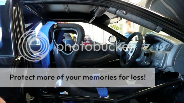

The cage is a very high quality job. Gusseted in some places, reinforcement plates wherever possible have been welded in and smoothed over, cage extends through the firewall to the back of the front shock towers and the tubing around the roof and sides is all seam welded to the car. Being all black inside you can't see much in the photos.

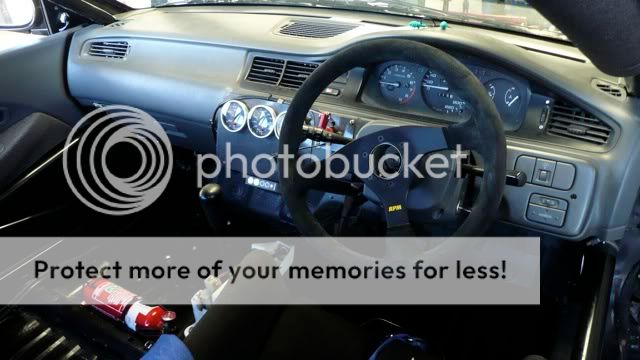

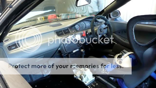

We also wanted to keep it nice inside and retain as much trims as possible. All the trims like the dash and the rear side panels have been cut nicely around the cage (not just hacked up) and the door trims have been nicely cut to the shape of the cage (you can see in the picture). All washed, cleaned and destickered (inside and out) it just looks like a nice, be it hardcore, street EG, which funnily enough it is still rego'd and driven to the track.
It still has fully working electric windows and mirrors and all the gauges on the OEM dash function and work.
The links on the first post page one show quite alot of pics of it at the IPRA Nationals, you just gotta scroll through the other cars which can be a bit time consuming.
Splitters are permitted within the rules. Actually the car is quite conservative when compared to what the rules actually allow. given time it will become even more radical to what you see here - hopefully all within the rules :)
