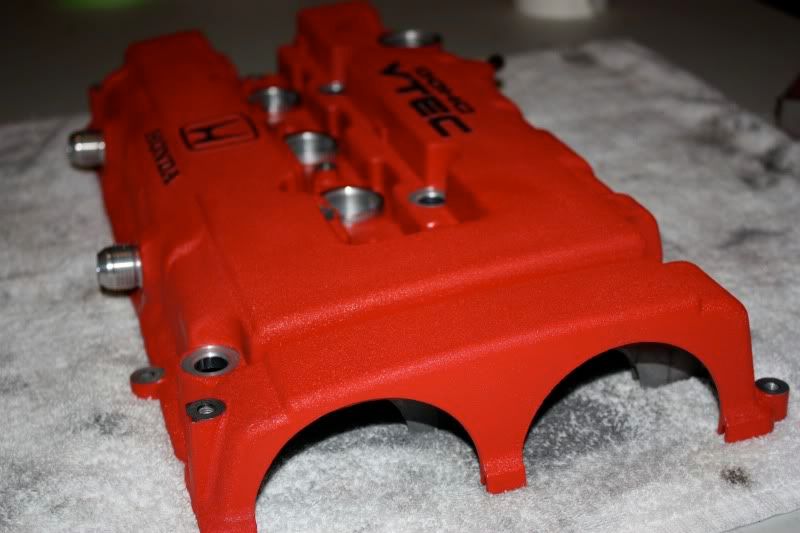

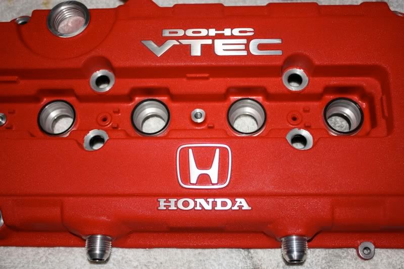

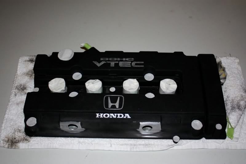

heres my rocker cover beofore and after images don't have in pics of when i was doing it tho i will write up my steps tho.. mind u i am a spray painter so alot of equipment u might have to get will cost a bit, easly done for around the $50 mark :)
before:
http://img440.imageshack.us/img440/2999/dscf5618oi1.jpg
Shot with FinePix F410 at 2007-07-11
after:
http://img256.imageshack.us/img256/5194/dscf6238gp2.jpg

go to your local paint supplier prob repco super cheap etc, and get some paint stripper, (remeber to wear necesarry safter equop for this mask, GLOVES etc) my cover was already yellow as u can see from the pics which had just been painted straight over the factory crinkle finish black as most of yours would prob be,
simply cover thoroughly, don't be shy on this coat it on, and cover with plastic, i left mine over night prob a good hour os so should do it, becuase of mine being panted twice i gave it to coats of stripper,
STEP 4:
grab your self a paint scraper and go to work, getting off as much off as u can, nest i used a red scotch bright pad and water (running hose) to get rid off all the excess, (this is inprotant to make sure all the stripper and any bits of paint flake are all gone, at my work i put it in a hot wash to ensure this, most prob owuldn't have this wo all i can sugest is maybe soak in in a sink of hot water or with a high pressure hose.

ok now heres the first stage off your painting prep work, all was left now was a bare metal cover, i then used a 1K base metal primer which u should again be able to get from your local paint shop, coverd that, not fully just a cover coat, then let that dry..
Step 6: now time for your paint, red wrinkle coat pressure pack,
on the back it had directions as to how to do it so thats all i followed (i was also doing this in a propper spray oven so drying time between coats etc were cut, simply spray one coat diagonally, ur next will be horrozontaly, and third verticaly etc jsut following directions on the can..
it is important to make sure u let the cover 'tak off' or go sticky between coats, in the oven i waited atleast 10min between each coats and even then was taking ages to dry,
as ur applying your coats your prob goin to find it is pink at first, when u come to your second it will be more red then when ur finished will be the full effect, also there isn't any reall crinkle effect untill FULLY dry,
also u will find there are spots uve missed and will just touch up certain bits, would strongly suggest agains it as now mine is finished some spots ahave a more crinckled effect in areas to others, just make sure u give good even coats each time..
STEP 6:
now as for drying time at work i baked mine 3 times even under infer red lights and still took all that to dry, it says on the can to leave for 48 hours to fully dry which i htink is the best idea..
SPARK PLUG CENTER PIECE COVER:
STEP 1:
for this its a must to Prepsol (WAX AND GREASE REMOVER) the cover off as i found i got alot of wax and solvent boil through my first coats because of this,
i used a scotch bright pad (which u probbly will already have) and prepsol givving it a good scrub, then dry it off and go over with a dry scotch pad to get any shiney bits u may have missed,
nect shoose you colour u want for the centre piece i used a 2K silver with a blue pearl, if at home jsut agrab a silver spray can, will do the job ;)
and there u have it, ur new type-r rocker cover, u may want to clear it i havne't as yet and am still unsure weather to or not jsut personall preffernace as i don't like the shiney look..
