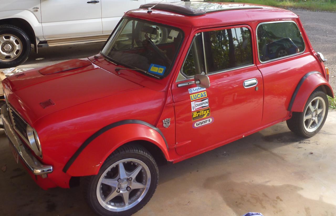

Present - I have a 2nd hand B18C7 long block (110,000km old) ready to connect to the almost brand-new gearbox.
I'll put a new timing belt on at the same time, but is there anything else I should be replacing now since the engine & box will be out of the car?
I was happy with the standard clutch, & don't want to upgrade it as my modified pedals mean that the clutch pedal action is pretty heavy anyway. The car is so light I break tyre traction well before upsetting the clutch.
Can you guys think of anything else I should be fixing/replacing now? Once it's back in the car there is no room to work on the engine. Even getting to the alternator to adjust the belt is a struggle, with skinned knuckles as a result.
