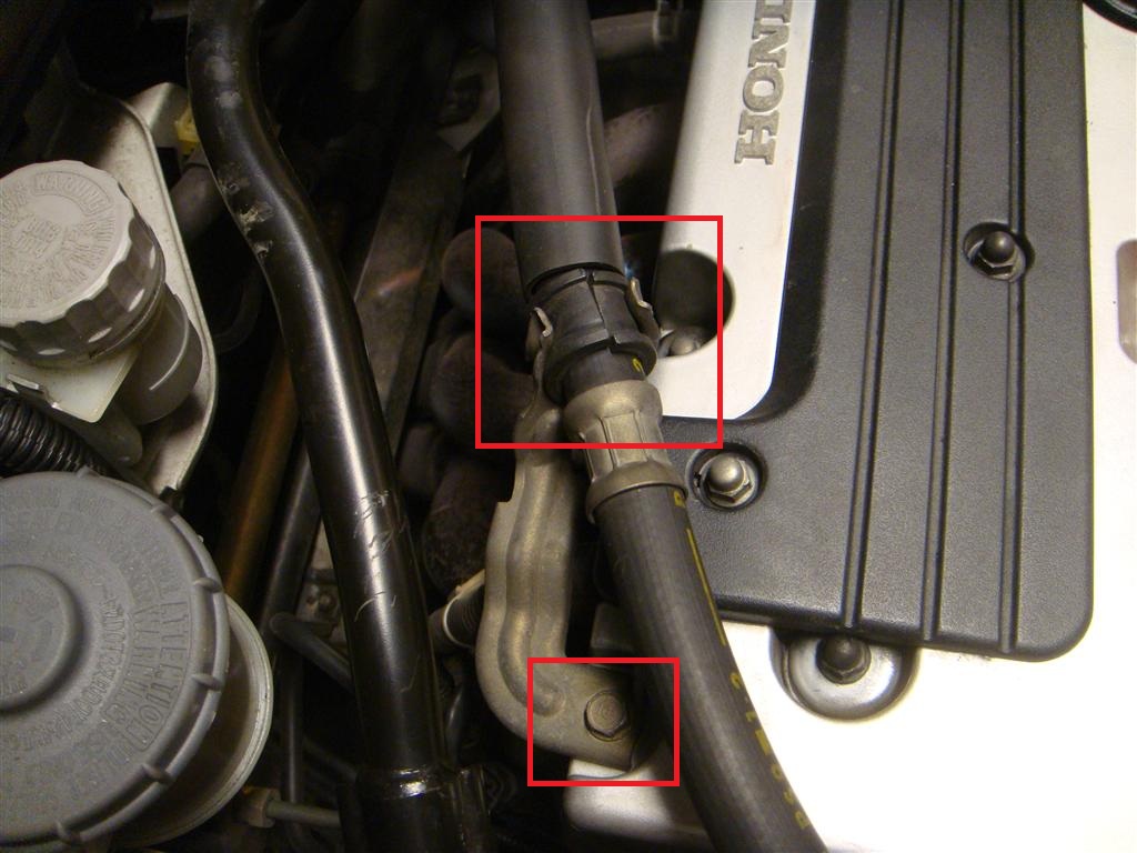

1. Remove the hose from the bracket and loosen the bolt with a 10mm socket to remove the bracket
Attachment 18808

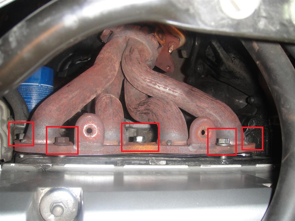

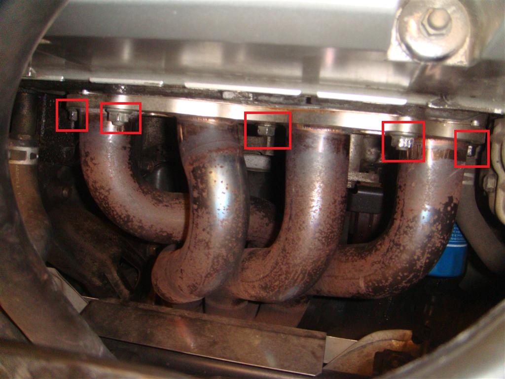

2. Loosen the 5 bolts/nuts (top 2 are nuts, bottom three are bolts) displayed using a 14mm socket.
Attachment 18806

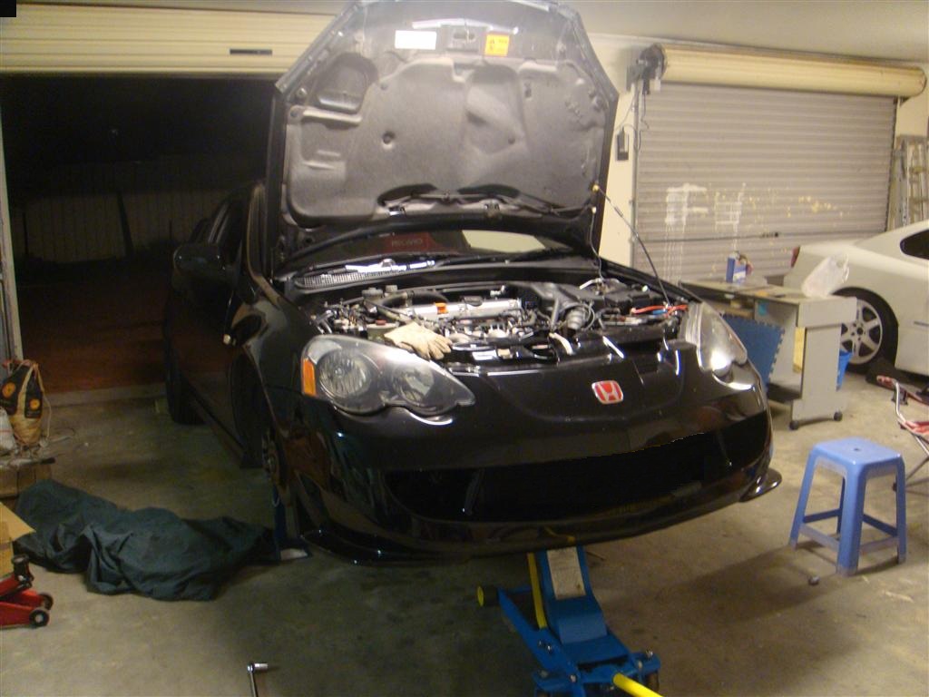

b. Loosen the wheel lugnuts and jack up the car. Place a jackstand at each side of the car and lower the car onto the jackstand. (I kept the hydraulic jack at the front of the car for additional support however most of the cars weight is on the jackstands - there is not much of the cars weight on the jack).
c. Remove the lugnuts and take of the wheels
Attachment 18803

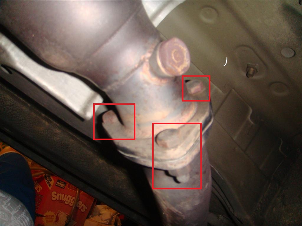

4. Go underneath the car and remove the 3 bolts/nuts (14mm) that are used to hold the cat and catback exhaust together. (Note: on the stock cat, the bolt is welded onto the car so you need to remove the 3 nuts only)
Attachment 18798

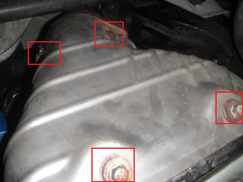

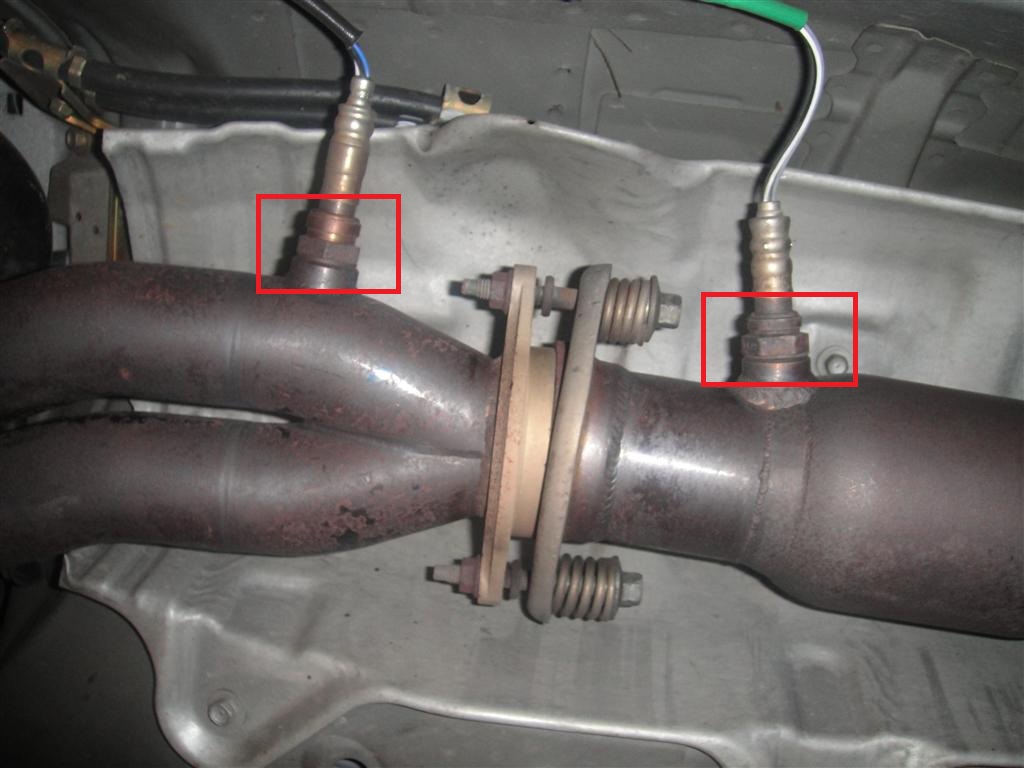

5. Remove the primary and secondary from the header and cat. I think they were 22mm. I used a spanner but if you have one of those deep sockets with a slit on the side for the cable to run through then it would be much easier.
Attachment 18800

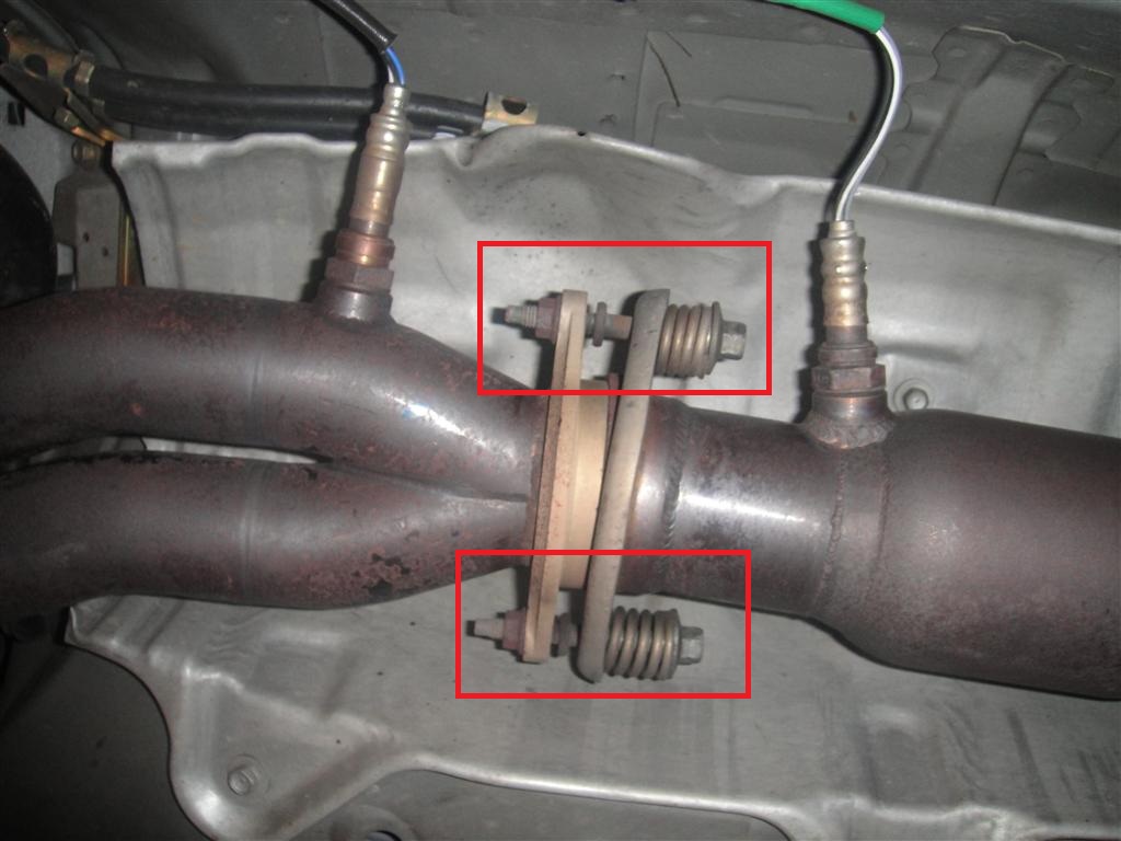

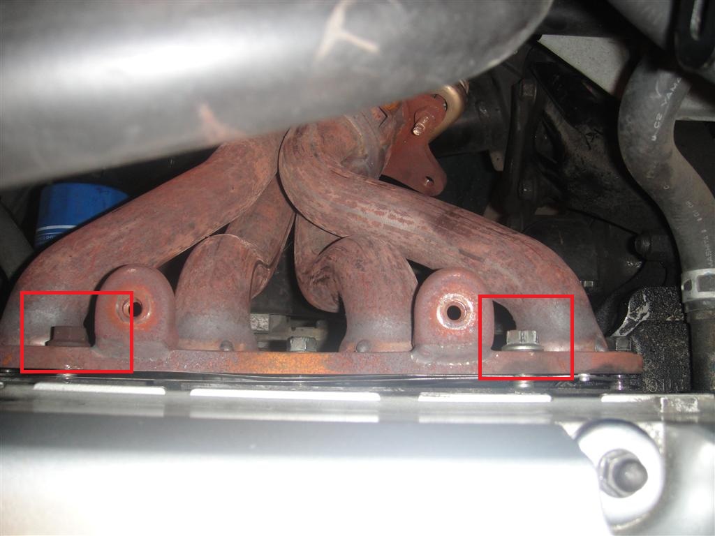

6. Remove the 2 spring loaded bolt/nuts (12mm from memory) that holds the header and cat together. At this point the cat should be unattached. (Note: I had to do this as there wasn't enough room under the car to take the header off.
Attachment 18810

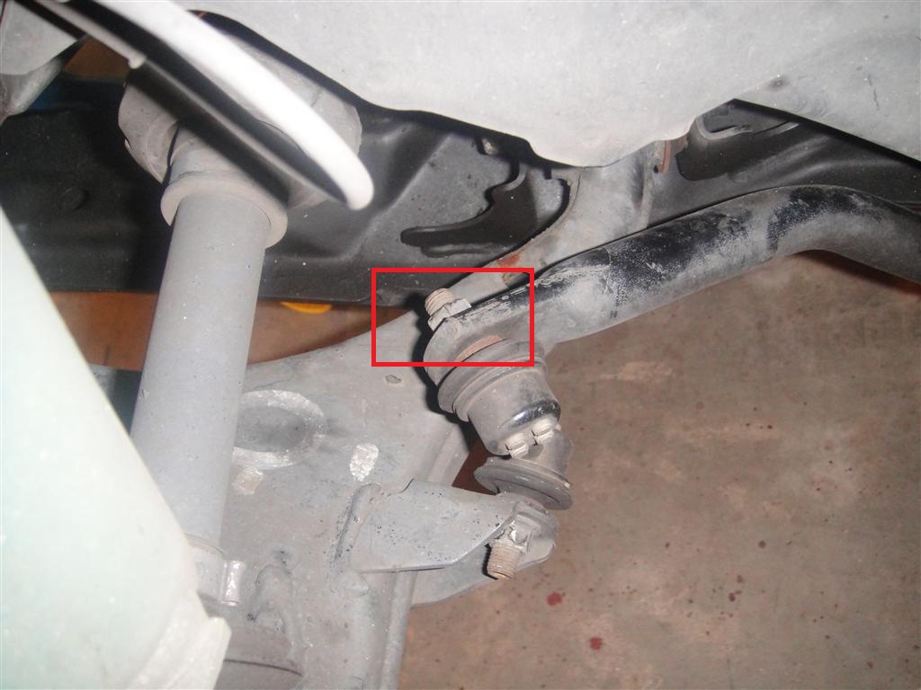

a. Remove the endlink from the swaybar but removing the nut with a 10mm and using a allen/hex key to hold the bolt inside of the nut (You'll understand this better once you see it). Do this for the left and right side.
Attachment 18807

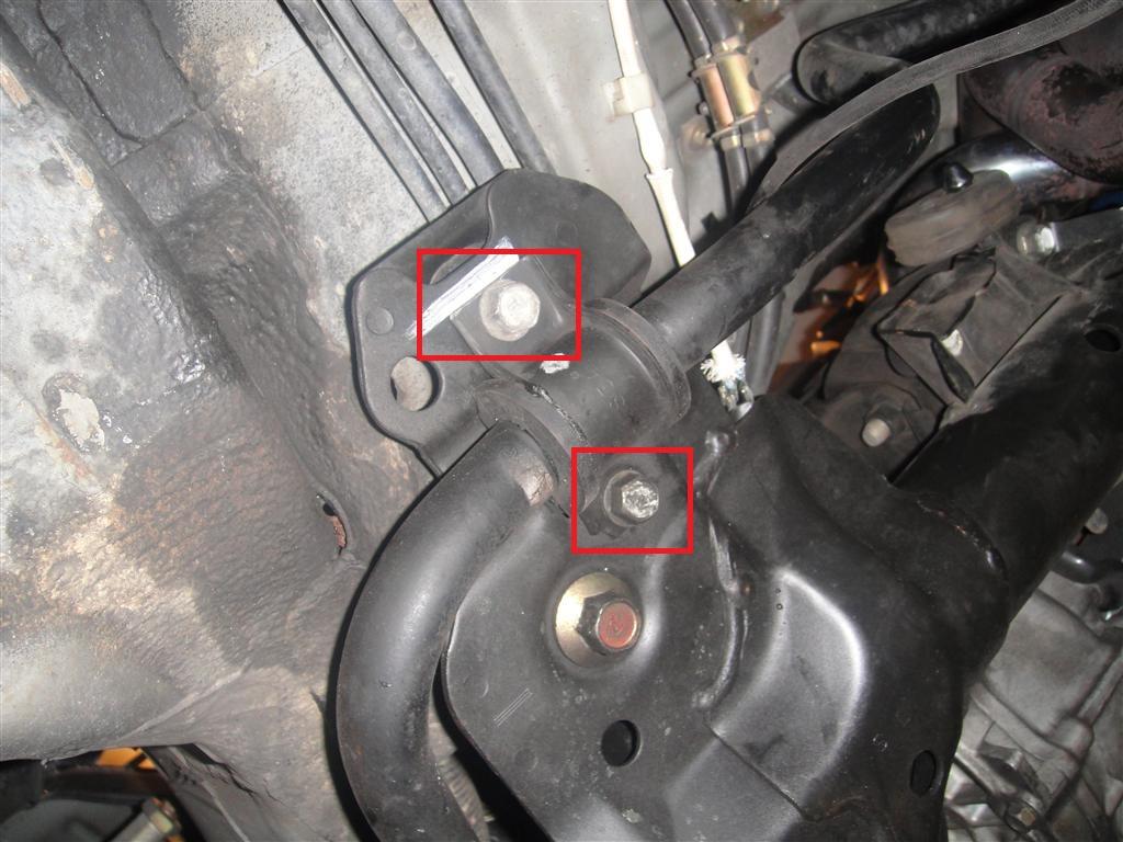

b. Go underneath the car and remove the swaybar mount by undoing the 2 bolts (I think it was a 14mm). There are 2 mounts for the sway bar.
Attachment 18811

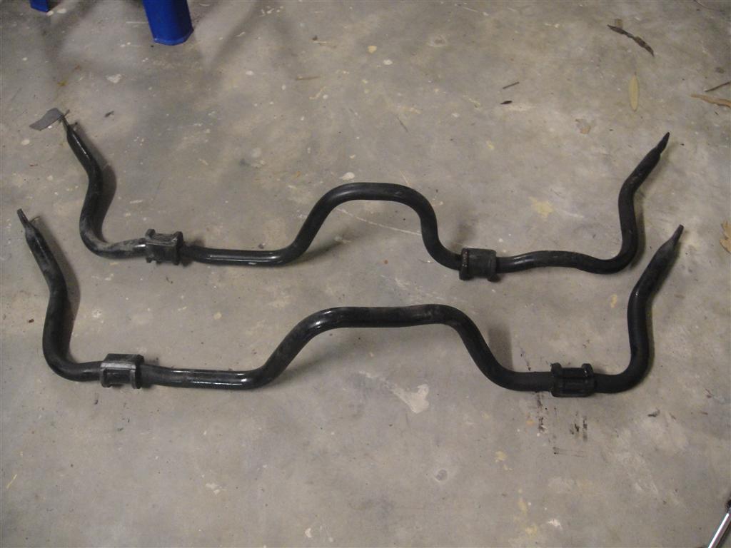

c. This is the comparison between DC5R (top) and EP3 (bottom) swaybars. You can see the EP3 swaybar has more room to accomodate aftermarket headers.
Attachment 18801

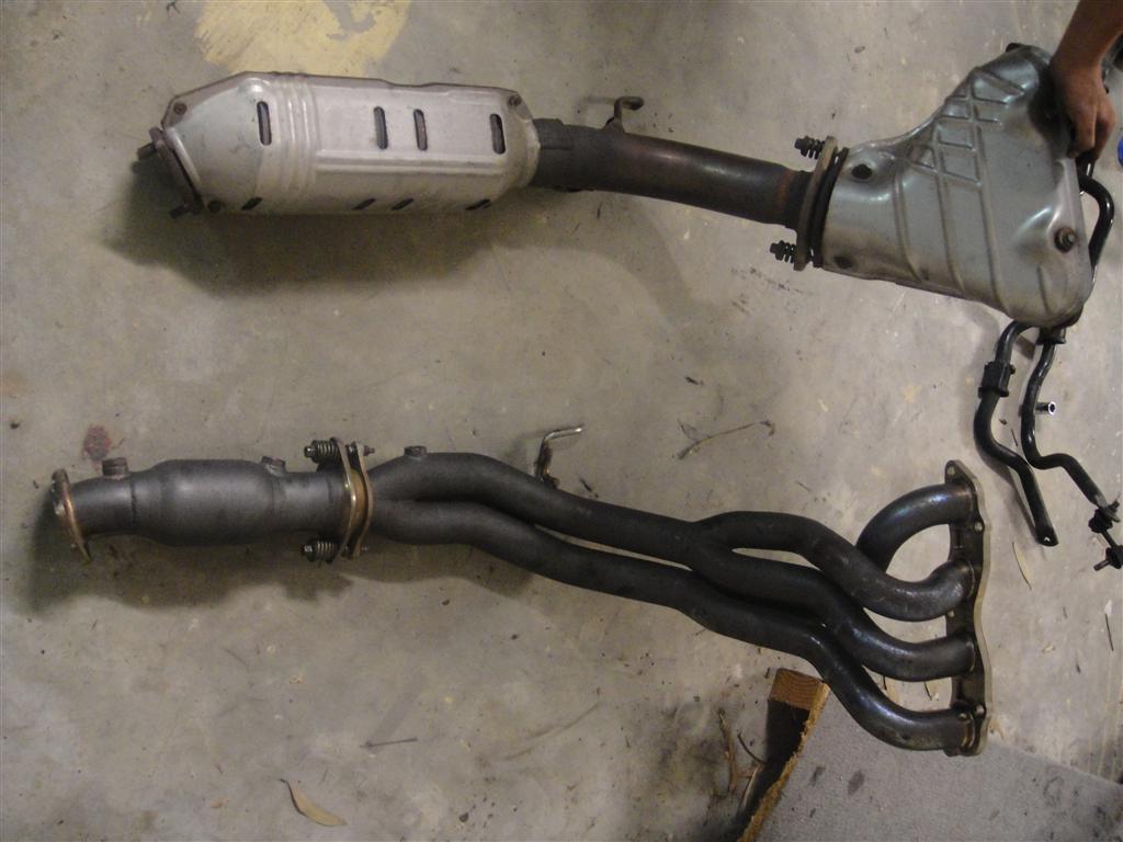

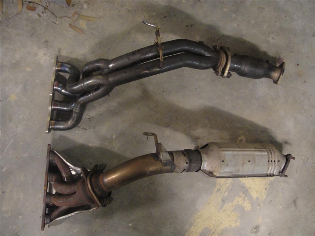

9. Remove the header from the car. This is the comparison between Toda headers with cat and stock headers with cat.
Attachment 18799Attachment 18802
