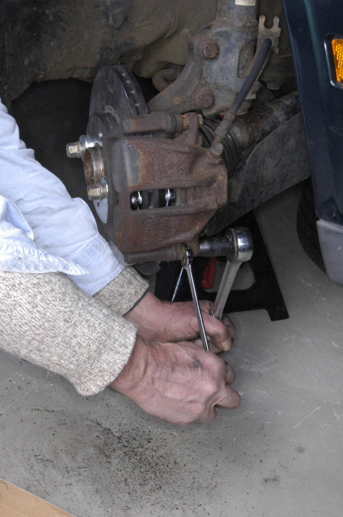

    Quote Originally Posted by aaronng View Post
    No, the only part that I torque up would be the wheelnuts and that is with my human torque wrench.
    There is no space to get a standard 1/2" drive torque wrench into the wheelwell to do up the caliper bracket and the caliper mounting bolts.
    You should always torque the caliper bolts.
    Turn the steering outwards to get better access to the bolts like so,
  3. #39
    Ninja turtle aaronng has a reputation beyond repute aaronng has a reputation beyond repute aaronng has a reputation beyond repute aaronng has a reputation beyond repute aaronng has a reputation beyond repute aaronng has a reputation beyond repute aaronng has a reputation beyond repute aaronng has a reputation beyond repute aaronng has a reputation beyond repute aaronng has a reputation beyond repute aaronng has a reputation beyond repute
    Join Date
    May 2004
    Location
    Sydney
    Car:
    Chloe
    Quote Originally Posted by EKVTIR-T View Post
    [IMG]http://saturdaymechanic.com/wordpress2/wp-content/uploads/2012/02/18.-Attach-the-caliper-680x1024.jpg[IMG]
    At the rate that I am torquing it, it is above what the service manual recommends. And yes, I do it in the exact same way as in that photo, with a spanner and ratchet.
    However, you still can't get a torque wrench into the area where the caliper bracket bolts are. That is behind the rotor and the torque wrench ends up having to point upwards into the wheel well. Fine if you have a 4x4, but not enough clearance if you have a passenger car.
    Stocky CL9 - 1:17.2
  4. #40
    Member EKVTIR-T has a reputation beyond repute EKVTIR-T has a reputation beyond repute EKVTIR-T has a reputation beyond repute EKVTIR-T has a reputation beyond repute EKVTIR-T has a reputation beyond repute EKVTIR-T has a reputation beyond repute EKVTIR-T has a reputation beyond repute EKVTIR-T has a reputation beyond repute EKVTIR-T has a reputation beyond repute EKVTIR-T has a reputation beyond repute EKVTIR-T has a reputation beyond repute
    Join Date
    Oct 2004
    Location
    www.alibaba.com
    Car:
    rebirthed_ek9
    The torque wrench shouldnt be up in the well.Use a shorthandle 3/8 from below in the same position as above pic
    One point to add he is holding the tools in an awkward manner.Far better to position yourself towards the front with right hand pulling toward your body
